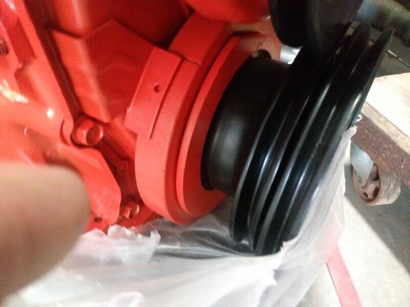

like this one?

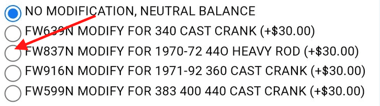

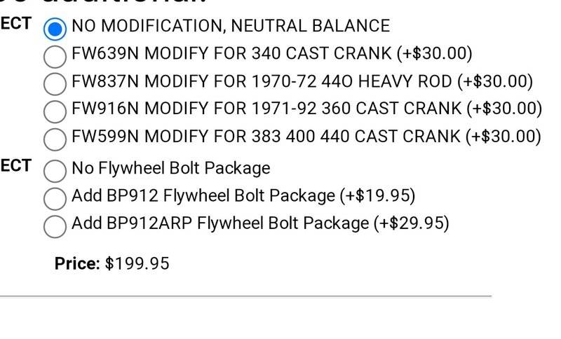

These are the flywheel/convertor balancing differences for small and big blocks.

Curious Yellow 71's post shows the correct flywheel.. I think thats Brewers website..
