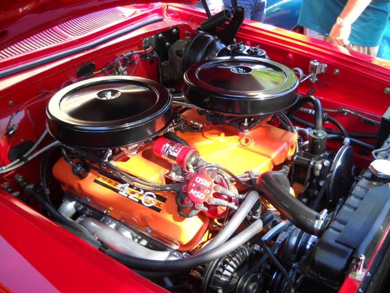

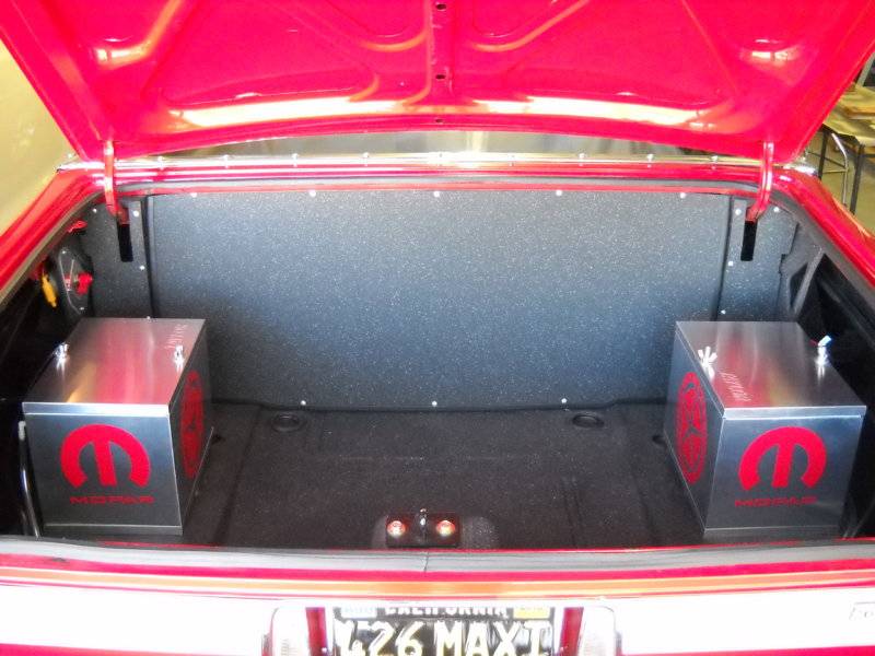

How about some FI details & pictures showing under the hood? :D
Sure. I'll throw a bunch of pictures on here. Most of my learning curve on the FiTech came from the Chevelle forum and from FiTech. I recommend calling them if you have a problem or need information. Faster service than email.

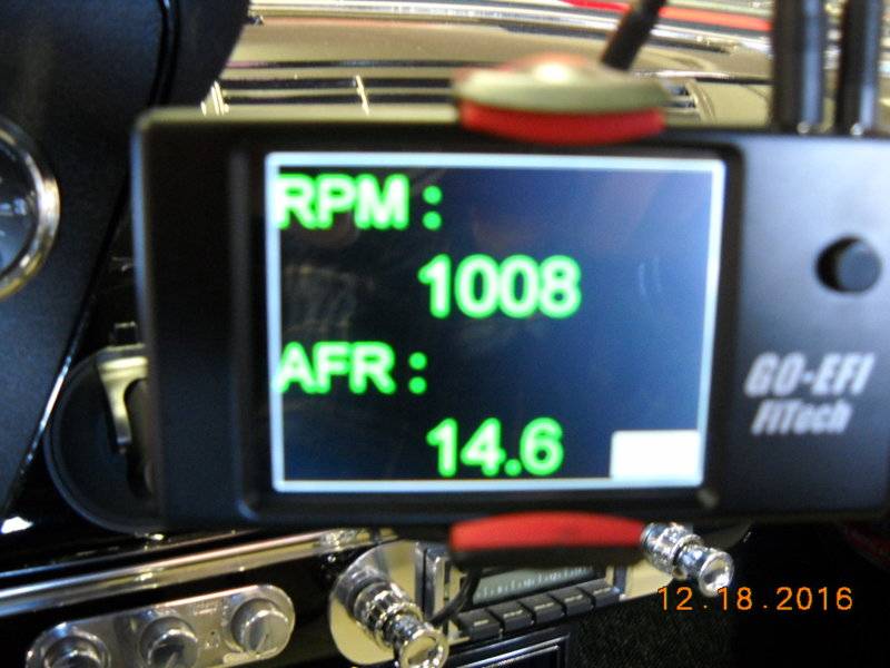

The car runs great, as good as it did with 750 cfm and then 600 cfm Edelbrock carburetors. Faster starting, immediate stable idle, no warm up period and very crisp throttle response. My only complaint now is that the handheld device reads coolant temperature about 20* less than actual, as measured by an Autometer mechanical gauge and an infrared temperature gun. According to the owners, they are working on a feature that will allow you to sync the two.
