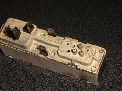

Hi, I need to have my 65 satellite heater control rebuilt. some of the vacumb fittings are broke off the back of it. If anybody knows a good place to send this and have it rebuilt Please let me know. Thanks Moparty
That happens a lot. I'm not sure of a place that repairs them though. Most people (myself included) drill out the bad ones and epoxy in same sized copper tubing from the hardware store.

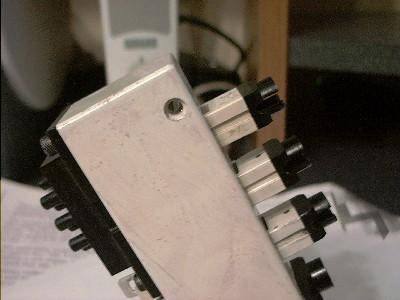

I seem to remeber someone out there sells a aftermarket billet aluminum block that is meant to replace the brittle plastic piece. Thought I saw it on the 62-65 Mopar or no Car site, but don't see it now.

Almost all the switches in our old cars have the vacuum ports broken off of them. I have machined a repair kit to fix this problem.
I will repair your switch and send it back to you for $35.00,(money order or cashiers check only) shipping included. You can't buy these switches from any vender. My part will make it work like new. Also, something new I've added to the switch fix is a repair that will fix the slides that have the socket broken off that the push buttons fit into. Price is $5.00 each. I can only offer this if you have the vacuum port repair done. The labor and cost of shipping would be too great otherwise. View vacuum control switch example

before
after
