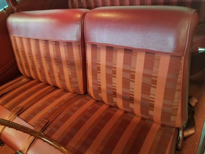

Can someone give me the measurements for the front seat, backs for a 60/40 split bench.
I need to modify a 50/50 split bench seat to the 60/40ish combo for my Dart and I have no idea what size they are supposed to be.
Thanks, Mark
I can do that tomorrow. How do you want it measured so I know I get the measurements you want.
Basically 20 inches drivers side and 32 inches on passengers side. I got a total of 52 inches all the way across so the passengers side could be about a half of inch less for the gap. I am pretty accurate at 20 inches on the drivers side. All these measurements are at the top of the seat. I am enclosing a picture so you can see that it is slightly wider at the bottom.
