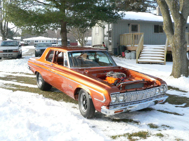

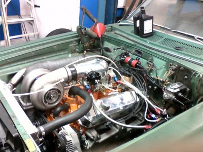

Actually the car is my sons. It is a late non magnum 360. Bowl ported heads,reground factory hyd roller (.490" lift),stock lifters,Chinese rockers, new rod bolts,forged pistons,swap meet low profile single plane for hood clearance stock truck manifolds turned around backwards. 76 mm turbo,blow thru 750 on E85, no intercooler. push button 727,PTC converter,8 3/4 w/2.76, 255/60 drag radials. Very mild to drive on the street until you hit the throttle. So far we've only used 8 psi. This summer we're going to turn it up to 18 psi. If the tires hold we should be able to run ow 10-high 9 with the 2.76 gear. This is a pic of mine.

Thank you for the valuable info and if that is your 64 they are one of my favorites.I have a very nice 64 Belvedere 4dr and have gathered all the parts to make it a 2dr sdn.
Thanks again
