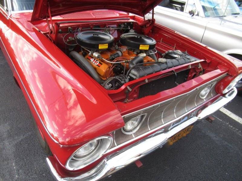

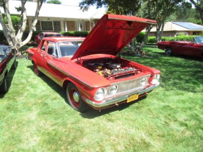

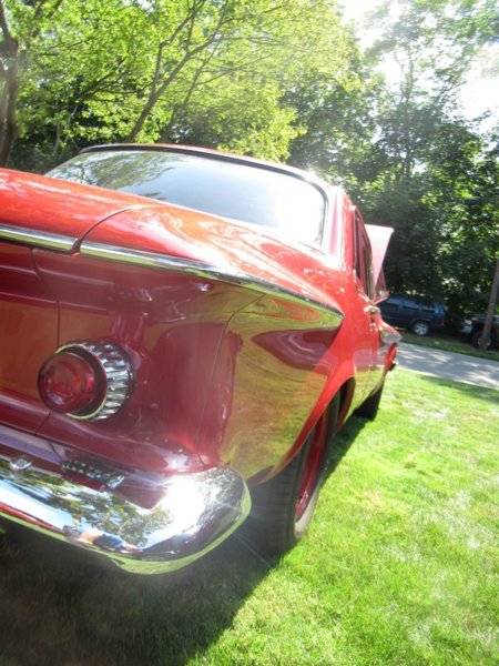

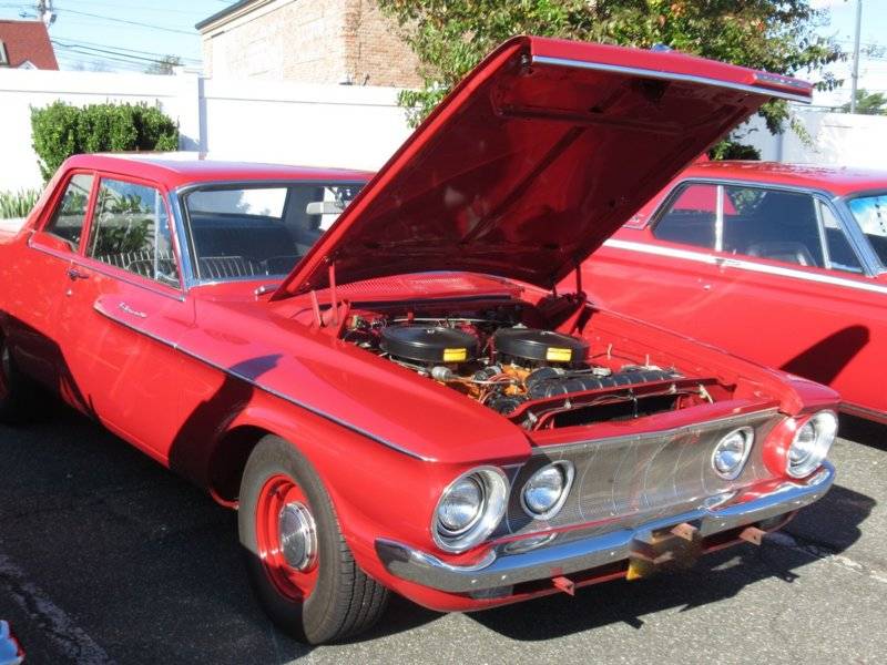

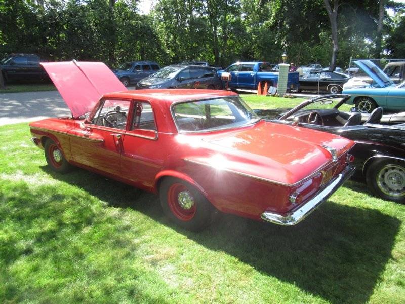

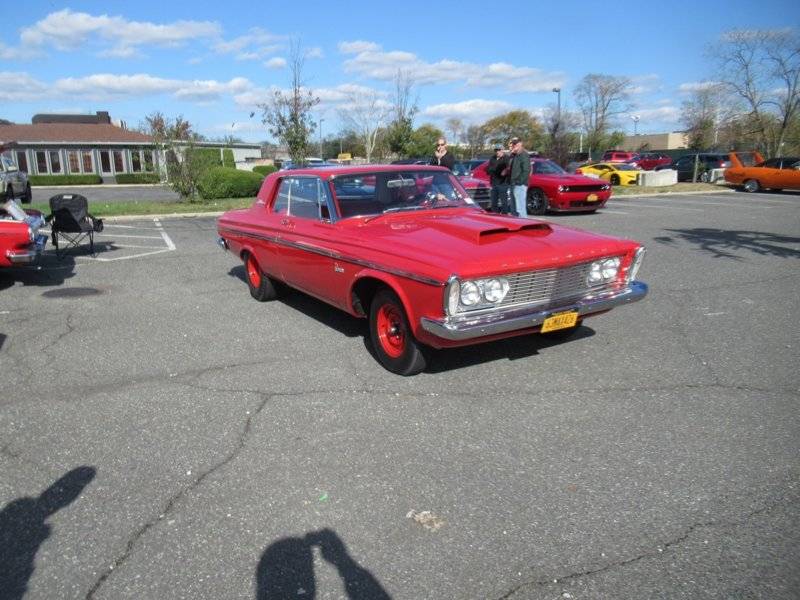

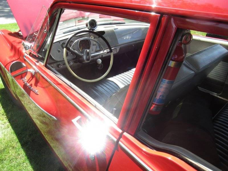

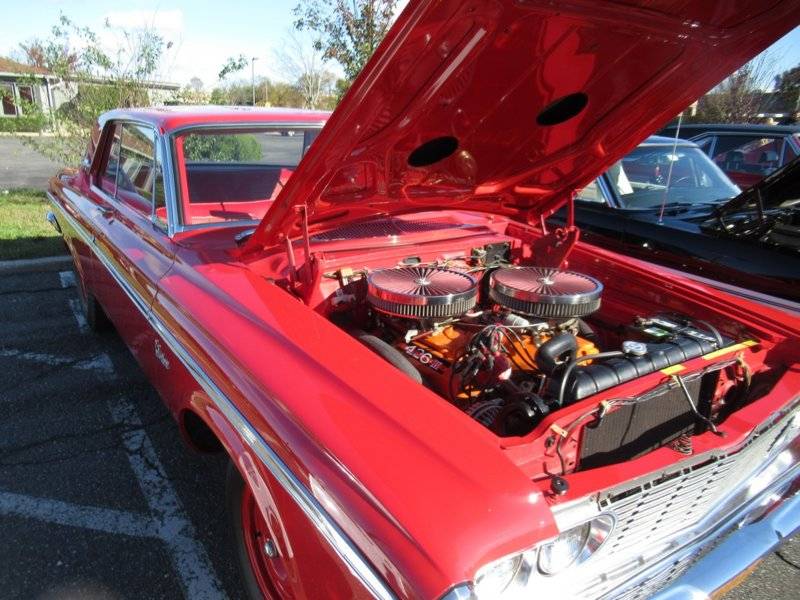

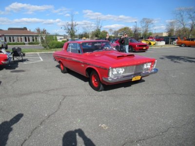

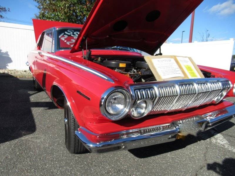

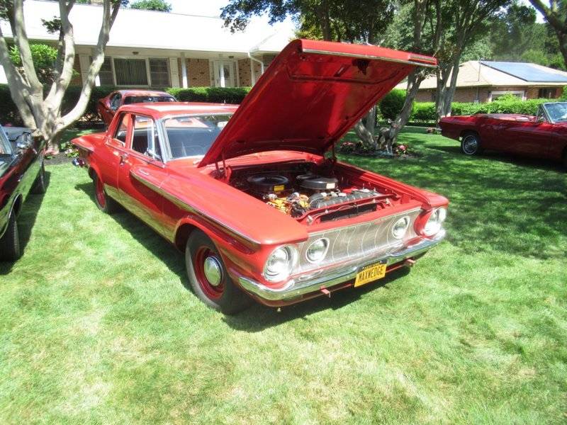

vin would say if v-8 car, also assy plant, all max wedge cars were built in Mi. lots of telltale extra holes in inner fenders for wiring, voltage reg was moved on firewall ,should be extra set of holes, under hood brake lines are special to max wedge cars.
We have several MW cars in our club.:thumbsup:
11.3.19 018.jpg 11.3.19 021.jpg 11.3.19 024.jpg 11.3.19 105.jpg 11.3.19 123.jpg LIM 8.24.19 009.jpg July 19 020.jpg July 19 025.jpg July 19 026.jpg July 19 027.jpg
