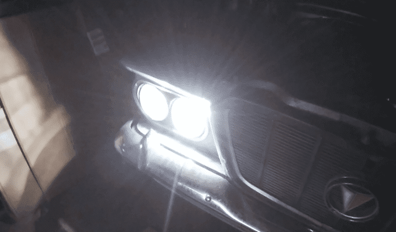

I put a ground hub next to my battery, pigtail to the battery negative, grounded all my lights to it. No more blown bulbs and lights are brighter than ever.

Thanks Matthon. Do you have a picture of your grounding set up? With the headlight ground already right on the other side of the support I wonder if it might be good to put a strap from it to the battery?
Ground hub at 8:35 and 15:47 in the video, grounded bright headlights at 17:20.

I chimed into a similar discussion on fabo, showed the pics of my headlights, and even after that others said the Wagner headlights I'm running are garbage. Garbage or not, moving the ground from the headlight surround to the ground hub made them a gagillion times brighter and safer.
I do this with all my cars.
Rant over, your results may vary, no warranties expressed or implied.
