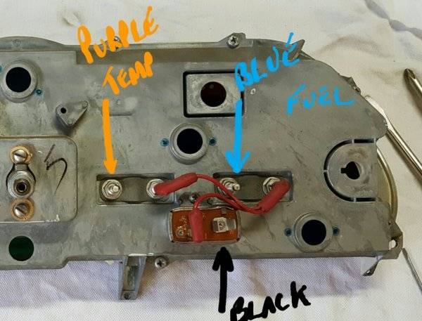

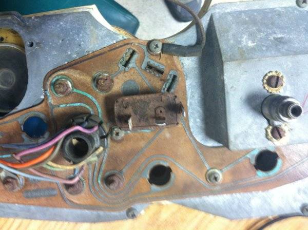

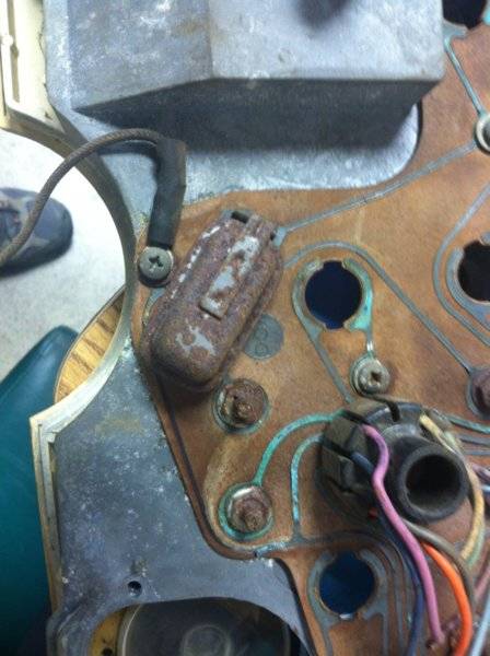

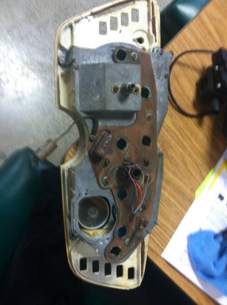

See what you are missing. My dash cluster has a clock and two speed wiper switch, so if you don't you won't need those terminals. I have more pics if needed. Your SMS has some good pics also with wireing color codes and wire guage sizes.
This is a cluster from a USA 62 Plymouth. You can see the voltage limiter in my pictures.
View attachment 550625 View attachment 550626 View attachment 550627 This is a cluster from a USA 62 Plymouth. You can see the voltage limiter in my pictures.
I am going to start with a new voltage limiter. Kramer is going to see if they have one if not Tonys parts have them. What is the wire that is screwed below the voltage limiter & has the round cylinder ? I notice that your dash cluster is different from a 62 Plymouth. My dads from his 62 dodge polara doesn't a circuit board
I think that's a static suppressor. This cluster is from a 62 Plymouth Fury, Sport Fury, Belvedere, or Savoy (all B bodies made in USA) Canadian Plymouth B bodies had Dodge clusters.

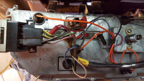

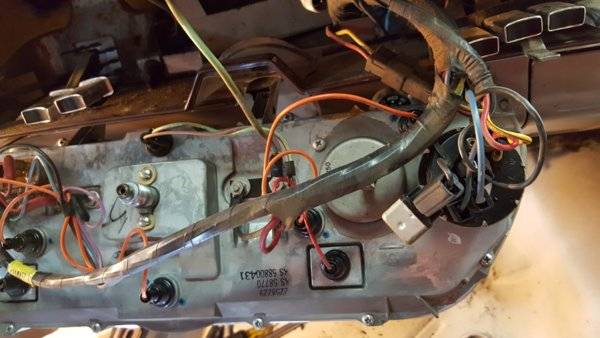

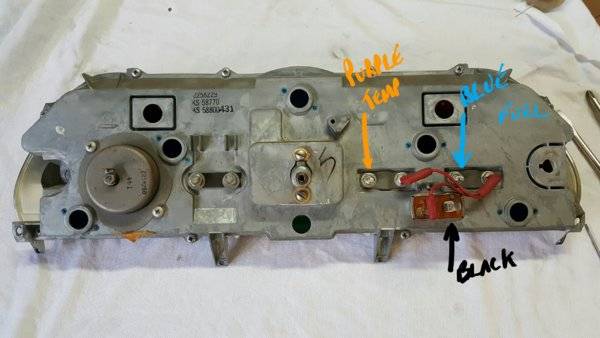

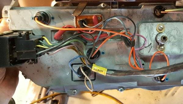

I took the gauge cluster out today. As in your picture the voltage limiter plugs in to the cluster. The one on mine has wires plugging into the voltage limiter. There is two red wires on the back of the fuel gauge. One of those wires plugs into the voltage limiter.
Maybe you can see the wires better in this pic. (Cluster is upside down)
