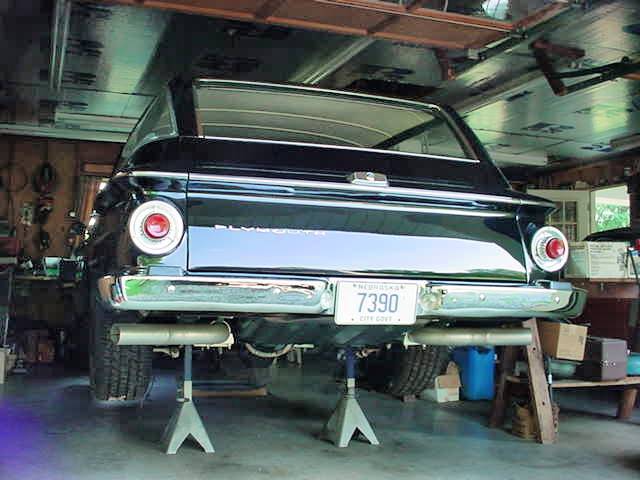

You should be able to pry them of,should be on same as wagon.
Sounds like yours may be held on with those barrel clips, like I've seen used on the "Plymouth" door script. I've messed with better than a half dozen 62's and have not run into that on the trunk lid letters. Who knows what may have happened over the years or perhaps different plants used different attaching mechanisms.
