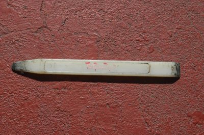

62 windshields are not that difficult to remove. I see no reason to give up and cut a gasket unless it is very dried out and hard, and I might add, I've only run into a few like that. First things first, you must remove the ss trim. This requires knowledge of how the clip looks like to know what you are releasing with the tool. Usually these are all rusted anyhow, and removal is pretty easy.
The gasket will need to have the locking flap pried out of its groove. Use a flat screw driver to start and run a blunt tool, such as the one pictured, to disingage flap from groove.
Next run the same blunt edge around the edge of gasket inside and outside of glass to loosen the gum or bonding that has occured over the years. Pry back the outside flap, since the glass needs to come out that dimension. Think childbirth here guys. Spray some soapy water or Windex (trademark registered) around glass edge.
