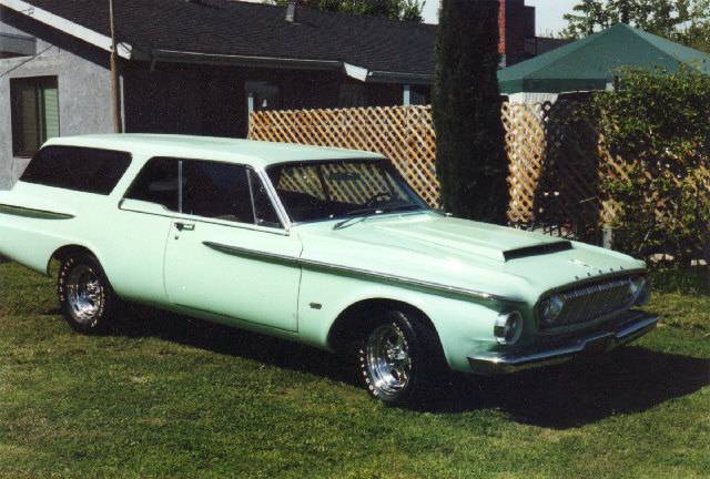

I did it the other way- went from 4 door station wagon to a 2 door hardtop wagon(62 Dodge) I found it very easy although it took some time and I've never done body work before. yours should be easier as you dont have to change door opening. I had to remove the B pillar post install the hardtop doors and then install the quarter panels.

no I sure dont. threw them away when I built the car in the 90's. they came out easy 6 spot welds and they were on the ground.if you have the hardtop quarter panels they should have the post built in?

I did it the other way- went from 4 door station wagon to a 2 door hardtop wagon(62 Dodge) I found it very easy although it took some time and I've never done body work before. yours should be easier as you dont have to change door opening. I had to remove the B pillar post install the hardtop doors and then install the quarter panels. View attachment 669347
Wow,that looks good! I had a dodge 440 wagon and a polara 2 door hardtop,both 63s. I wanted to do that also. Both cars had 383s with automatics. Was surprised to find the same wheelbase for both. But it didn't work out. Hey, can I ask what engine? I noticed the scoop. So I need to know! Thanks

the only dimension needed to determine if the car in question can be interchanged is the diminsion from the A pillar post to the C post in my case changing the 4 door wagon to a 2 door hardtop wagon was checking the distance from the base of the windshield post to the bottom rear most of the back window opening. the two door and 4 door are the same, and the changeover was EZ for me and I had never done body work of any kind before- but I was determined.
