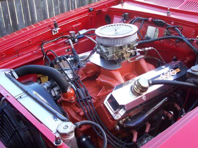

I bought a used manual box off ebay and it was in great shape. You can see some of the box in the pic and see how much room I have with the 440 block and 2" TTI headers. Ron
We aren't getting crazy with anything, and we will be using TTI headers as well. Right now the car has Dougs headers that had to be pounded into submission to clear. As it appears I will probably just order a rebuild kit and leave it bone stock, Im not really finding a ton of options that are better for a manual set up
I have Dougs Headers on my 65 Coronet with a manual steering box & have tons of clearance with no mods to the header
Ron, You have lotsa room there,not so much here.
