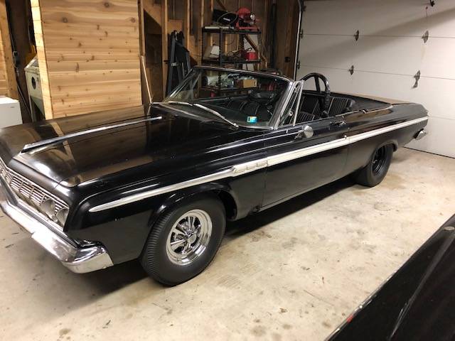

I too am working on a 'vert. Mine's a '64 Fury. I bought it from the original owner, and my top is shot. Been driving it for two years with no top, even in winter (when no salt is on the road). We just dress for the occasion. I purchased rubber seals from Steele Rubber Products. I have not installed them yet, so I can't really comment on whether they are high quality or not. The upholsterer I went to for a quote on a top didn't want to touch it until I got the rubber parts needed. He typically does Chevy stuff on '69 Camaros and Chevelles. Since this was not a plug and play type job, he walked away from it. Now I'm in need of some help, or I may just try to do it myself.

I too am working on a 'vert. Mine's a '64 Fury. I bought it from the original owner, and my top is shot. Been driving it for two years with no top, even in winter (when no salt is on the road). We just dress for the occasion. I purchased rubber seals from Steele Rubber Products. I have not installed them yet, so I can't really comment on whether they are high quality or not. The upholsterer I went to for a quote on a top didn't want to touch it until I got the rubber parts needed. He typically does Chevy stuff on '69 Camaros and Chevelles. Since this was not a plug and play type job, he walked away from it. Now I'm in need of some help, or I may just try to do it myself. View attachment 964683
