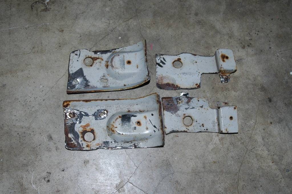

If all else fails I have a set that are rough, but you can get the dimensions to fab a set from them,
These braces are also part of the console brackets. The inner front are punched out of flat steel and are not just flat metal. The rear inners would be easier to fab as they are bent flat steel.

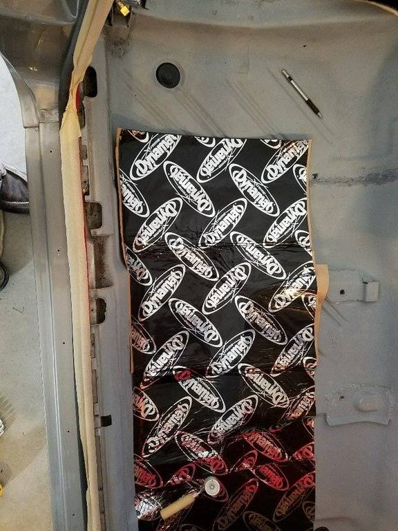

I had a buddy who welds put on the brackets I made up in his shop, when putting the buckets in my '63. Back then some 15 + years ago I couldn't find anything to buy anyway but if I gather a member has some or ask about the dimensions/ couple pics you should be good to go. I just dynamated my car and put in new carpet a month ago or could get you this info...
Took several photos of my dynamatting but my folder is full so some better pics didn't make it but here's one showing the brackets...case it is of help on configuration.
Thanks Ron. I do have a photo of both sides. Thanks for your help.

I will get a few pics of the ones I have ASAP
Chignikred's are in better shape than my spares
I will sell them to you if you can't find any
