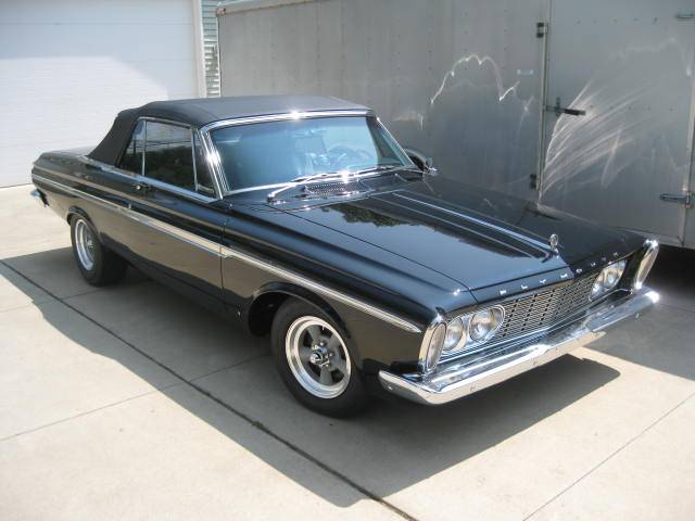

Looking for the largest pusher cooling fan to mount to front of my Radiator, with all the mounting hardware and hook ups. pictures of the complete system in the car would be a plus. I have a 1963 Plymouth Sport Fury, with a 22" radiator. Thanks, Tom.

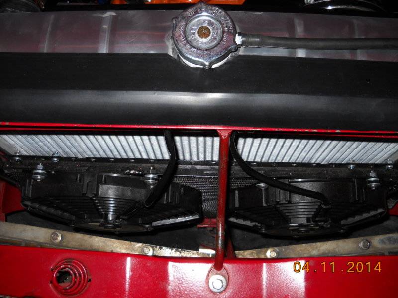

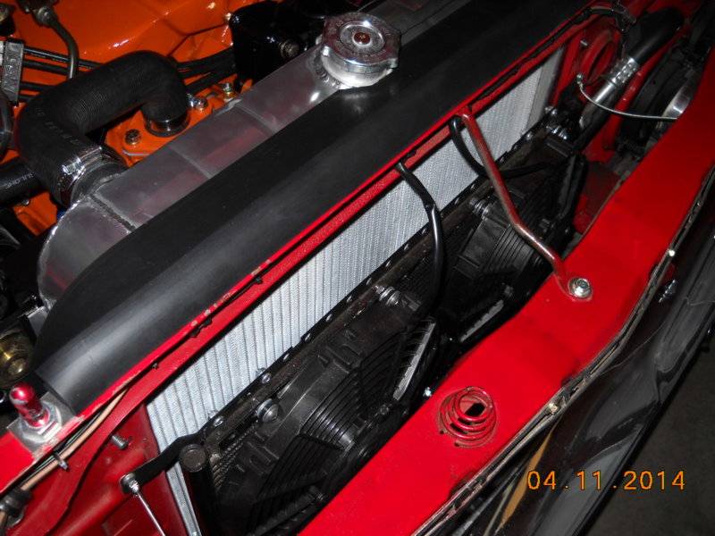

I couldn't fit a large pusher on my 63 because of the hood latch support being in the way. I used an 11" and a 12" Spal fan, one on each side of the support. I have a 100 amp alternator but the draw on the small fans isn't much.
Coloradodave, Thank you for taking the time to post and show your work in regards to the fan set-up, and the alternator size. I will pursue this arrangement and feel confident that cooling will be a success. Tom.
