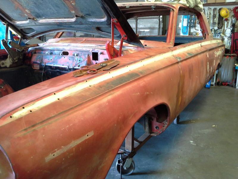

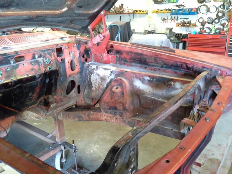

Anyone have a lower font valance for sale? this car was raced and i spent many many hours removing spotwelds and replacing pieces..making good progress

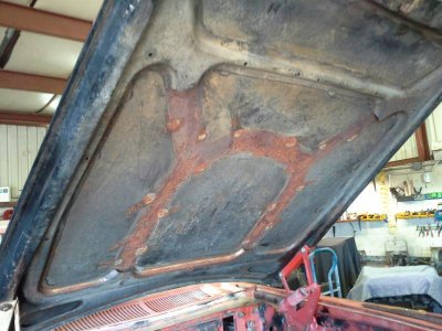

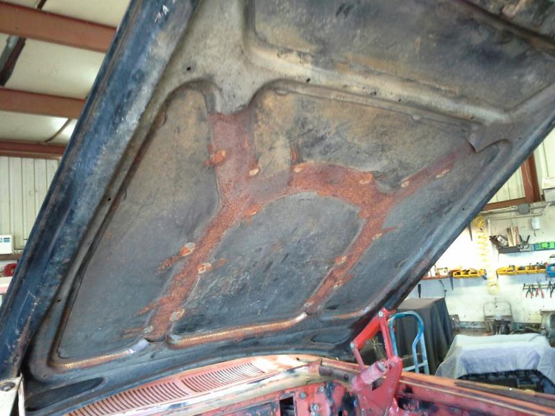

These are when I started, Ill post some new ones tomorrow
Strange how the area where hood bracing was removed ( at the factory) has rust .As if the bracing was on the hood for a long time and just removed recently?? or maybe it was never painted after brace was removed?
Is it a used hood?
Do you have all the pieces & running gear?
Would love a car exactly like this one ! :blob1:
This is a good I picked up from someone that modified it, the original hood was beyond saving. Everything matched up on the cuts. Ill pot some more, there has been a lot of progress since these were taken. I have 90%, I am missing a few pieces of stainless.
