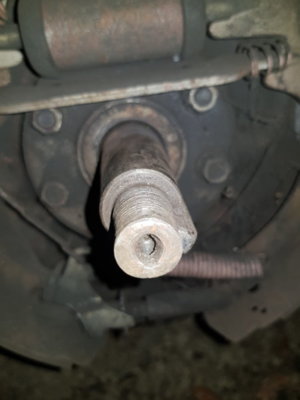

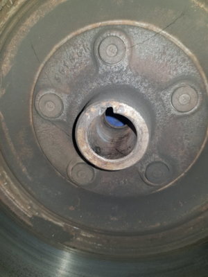

Hi all
I had a rear axle nut come loose the other day, I pulled over before I lost the wheel .
Just looking at it today and was wondering if anyone has any pics of how the drum etc should look ?
Its just different to what I'm used to seeing here Australia

That's how they are.
Do the brakes while it's off because otherwise they are a SOB to get off.
You will need a special puller for the other side.
torque these to about 230 ft lb min. and do install your cotter pin you should also have a washer before the nut.....while one cannot find these taper axles in the factory manuals is beyond me but the carry over from earlier year application is my source for the 230 torque and the procedure below...
minimum torque is the value to align the hole in the axle to the castle nut, if slightly off torque a bit more to get the hole to clear for the pin, do not lessen the value...
while upgrading to the newer drums is a plus and a maintenance convenience to no end, I take exception to the linked article on how to remove the hub. At no time ever will you smack the end of the puller with the sledge hammer...(ma Mopar makes strict notes on this to prevent damage) also not shown but an added advantage to all is the install of the nut on backward to the axle flush with the axle threads and a intermediate plate of sacrifice metal to protect against swage...your car your call but in any event protect your tools and parts while doing repairs
photograph #3 in post #1 looks like the axle shaft threads are slightly mushroomed. Using the nut on backward to flush with the thread along with a piece of 1/4 aluminum will prevent this. Drill the aluminum a bit on one side for screw tip to insert into..
while they can be stubborn...remember you can do this with tire and wheel on and when a stubborn hub fails to yield, you can keep the puller on in place with heavily appied torque and roll the car and do a couple turns and this actually can persuade a hub loose. It will POP with a BANG but with the nut in place, there will be no damage.
The unfortunate truth is that sometimes, even with the best puller, the drum won't come loose without a good whack on the end of the puller while under tension.
as stated, it is advised against...I have never seen the need for it yet and I worked a Salisbury (European Dana) that has proven to be the toughest one ever to remove in my life time....a 62 Volvo PV544....10 foot pipe and two fat boys later...still laughing at us. Next day...after pressure left applied....one tap and bingo we have a winner. They can be cankerous for sure

Yes, there should be a washer behind the nut. The axle end does look a little distorted but as long as the nut starts on there you should be fine. You'll see in my video I'll leave the nut on when useing the puller. Just leave at least a 1/4" for the drum to move. Protects the threads leaving the nut on there.
There is a washer and the thread is a bit stuffed at the end but I can get the nut on past the spilt pin hole, haven't tried tightening it up against the key yet though
