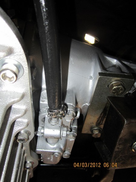

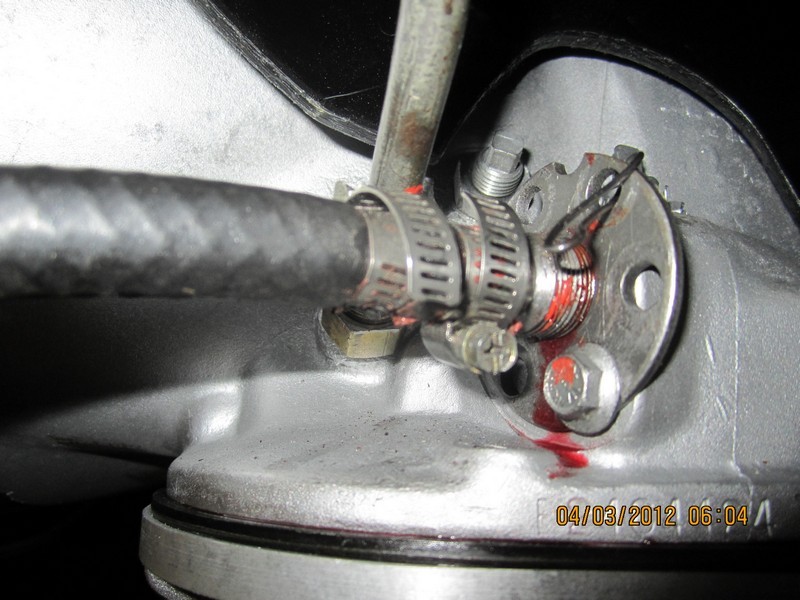

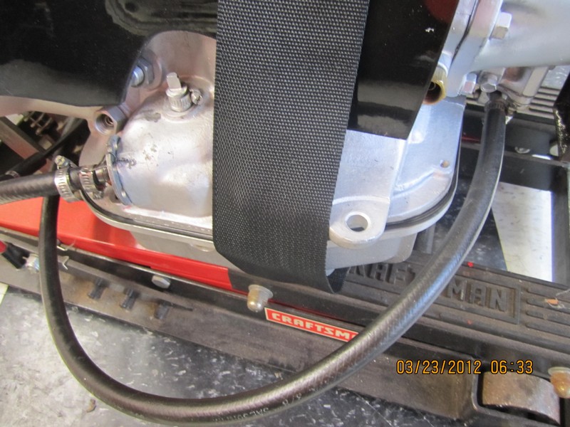

When my cables started leaking years ago,I slid fuel hose over the shifter cables with little hose clamps on the bottom.

I did the same thing HEMI-ITIS did with the fuel hose and small clamps. If it's not a 100 point show car, it's a cheap and easy fix, and believe me, I'm all about "cheap and easy".

Mine all used to leak. Easy fix. Get some heat shrink tube with glue in it. Slide it over heat and shrink. It won't leak again. If you can't find any send me your address and I'll send you some. Works perfect.
