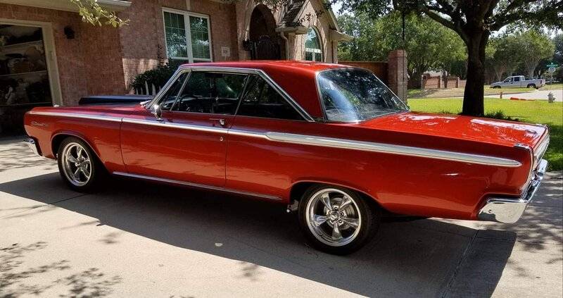

it's been years now....car is complete, sits in the garage cause it get 'bout 5 mi./ gallon, and doesn't like heat here in Texas

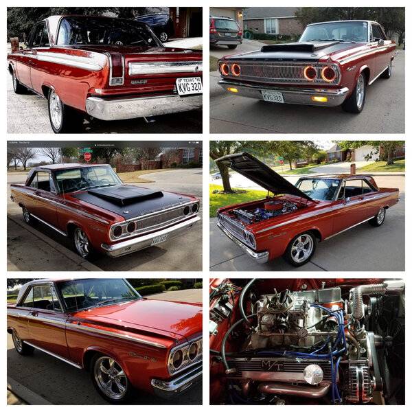

see pics with both hoods
Really like black out on hood with scoop. Like the color your ride turned out great.
Wow awesome 65. Great color combo. I like the both hoods. I've seen that "sunburst" hood before either on this site or another.
