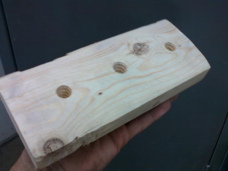

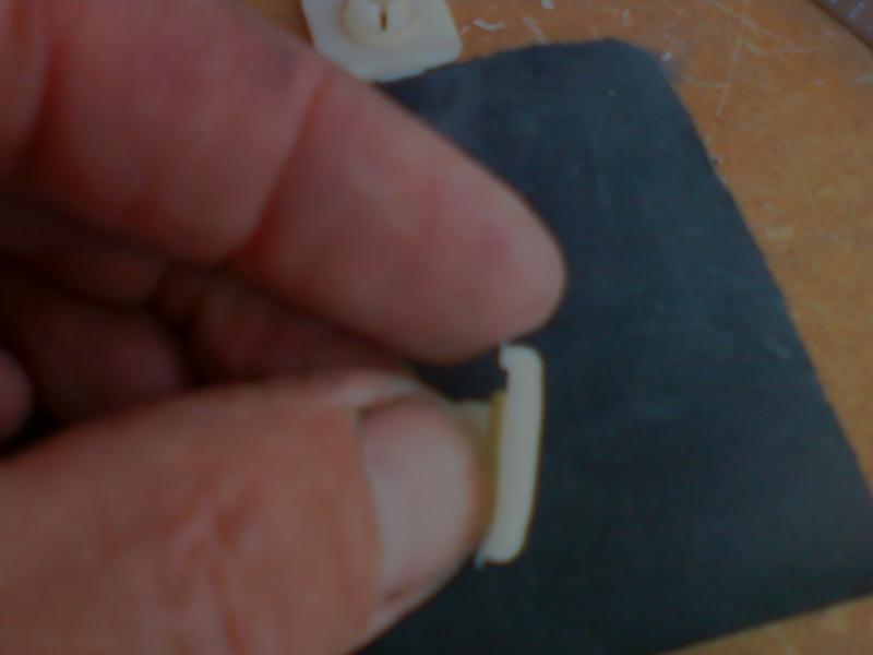

For those who are about to install Belvedere body moldings. The repop clips were found to be to large. They required trimming for ease of installation. After trimming a scrap piece of sheet metal was drilled and the clips temporarily installed. The the moldings were test fit on the clips. A block of 2x4 was shaped to fit the inside of the body as a backer when pushing on the molding during install.
thanks Doug, bought clips from RT spec. They are different from originals, insert does seem to be slightly larger as well as the fit on to the trim. When you say you trimmed them did you mean you filed the edge that fits on trim?

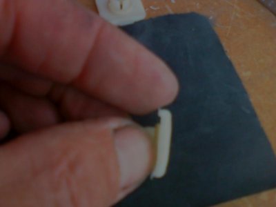

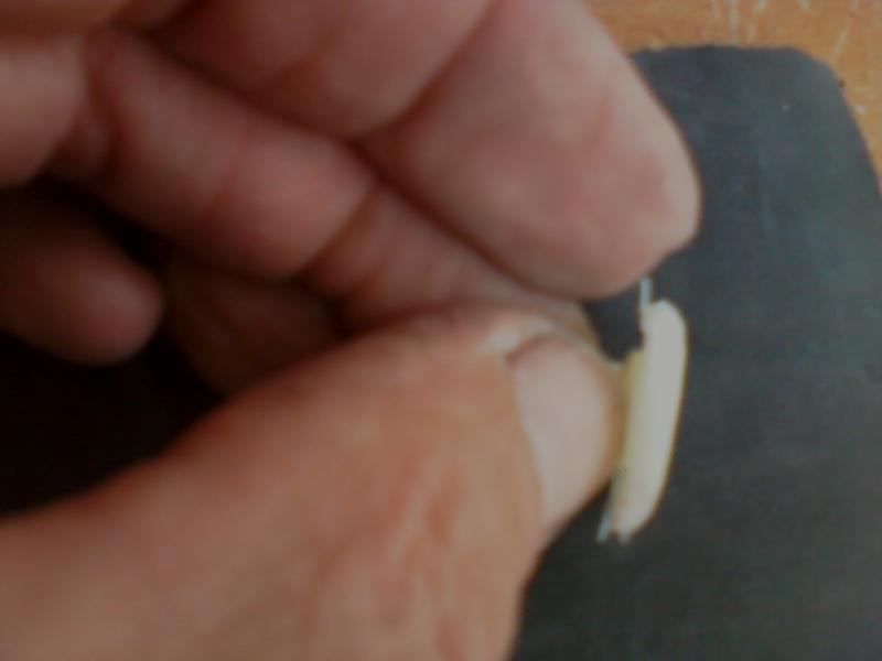

Finally found some pics.The backer bord for install. before and after of the clip, notice the sharp edge is removed.
Doug
