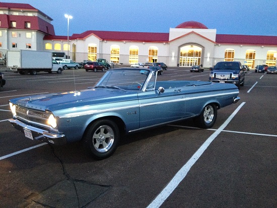

what is the largest wheels and tires I can put on my 64 Fury Convertible? I think 275-60-15 in the rears? I want it to look as though it has fat tires and wheels on it, without looking out of place. Anyone have pictures with tire and wheel size I can see?
here is mine
275/60 on back and 215/70 up front

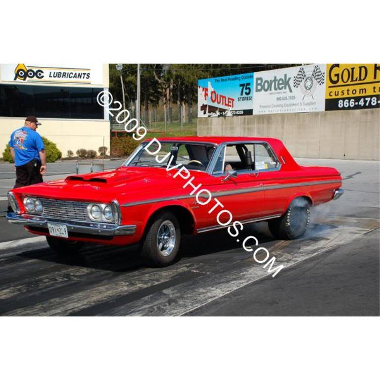

Coloadodave has a supersweet 63 Vert and maybe he will pop in and show his nice tire/wheel combo. Here is my 63 hardtop with 215/70-15's up front amd 30 x 9's out back. They all fit with room to spare in the stock wheelwells. Ron
