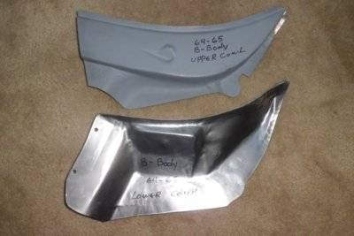

The only correct way to fix the problem is to cut the rusted metal out and weld in a patch panel, and removing the windshield is necessary since you would be welding so close to the glass. Patch panels are made for that section, https://www.c2cfabrication.com/products/1963-1964-dodge-dodge-440-lower-cowl-panel but they're a little expensive.

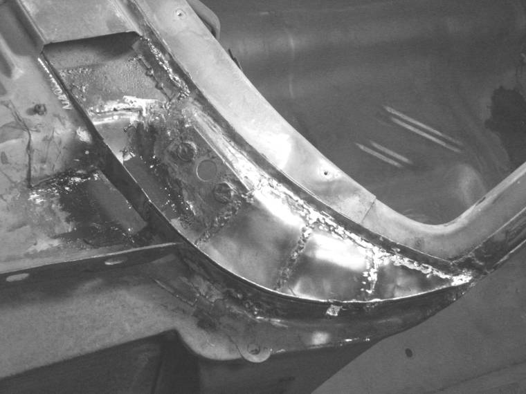

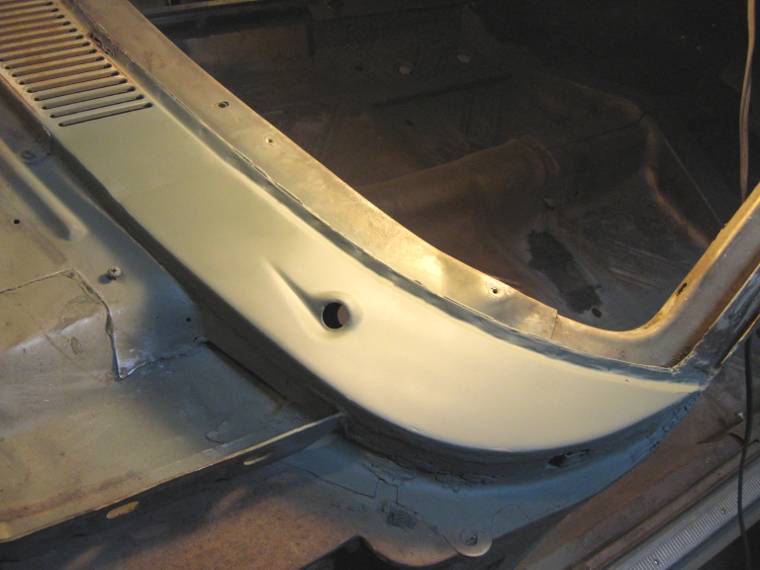

I'm cheap and I don't have all the metal forming equipment required, so I made my own from several small pieces of 18 ga. steel. When all the welding was done I sealed the area and coated it with POR-15. Then welded the upper cowl panel back in place. A little body work and that was it.

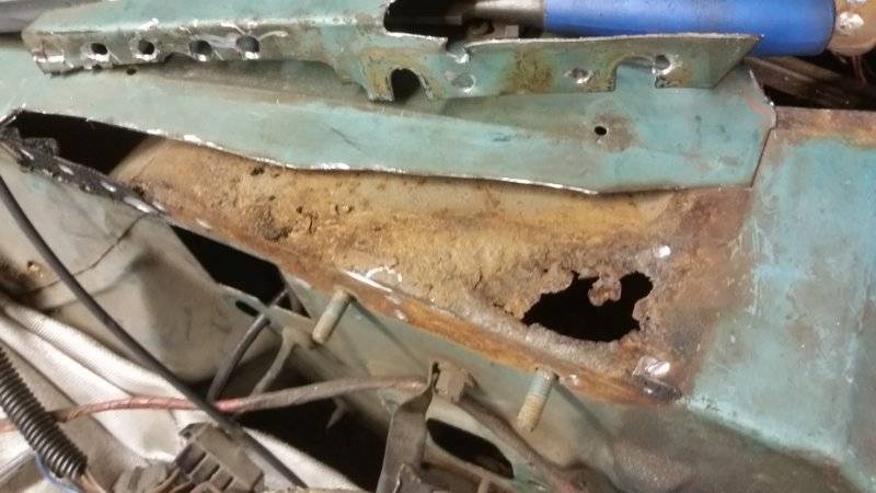

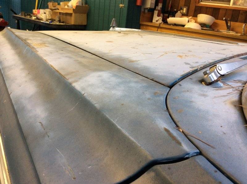

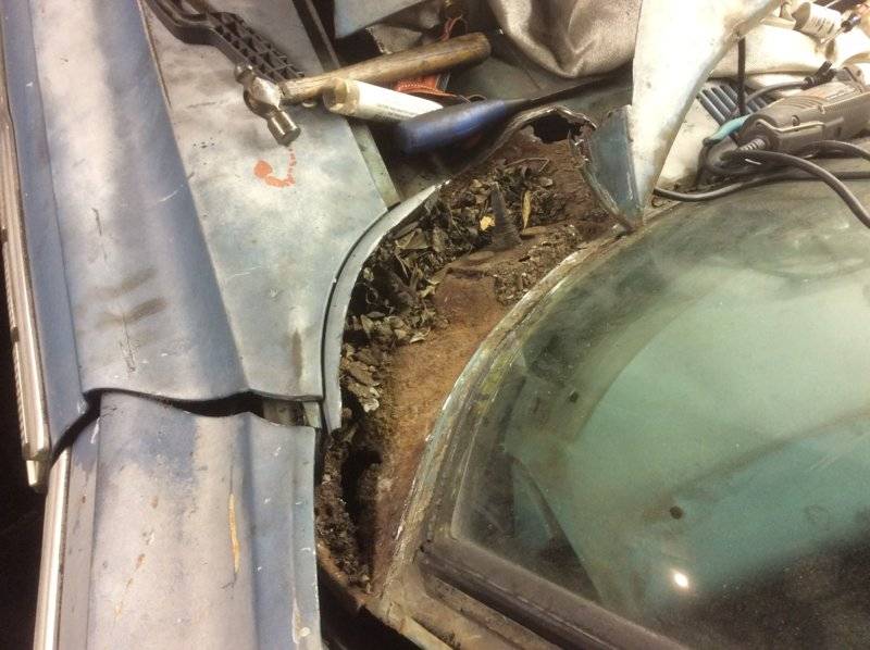

I did a whole thread on this recently. I have a 1964 Fury station wagon. My firewall is pretty solid too, but the 62-65 cowl area is prone to rusting out. It may look ok at first glance but there is very likely a lot more rust you cannot see trapped inside. There is design flaw which allows debris and moisture to get trapped between the upper and lower cowl, mostly on the drivers side.
I would highly recommend you remove the window although you could possibly get away without doing so.... but the welding heat would probably damage the window gasket and you'll want to repaint the cowl anyway.
You don't need to remove the dash, but that might make it a bit easier (I did NOT remove dash)
My original windshield was all scratched up and pitted so I left in in place while doing a lot of the work because I didn't care if it got damaged ( it helped protect the dash and interior from grinding and welding.) Then removed it once I was almost done... did primer, paint... and then had a brand new windshield installed.

If the manufacture is Sherman run and run away fast.............they are poor fitting junk.

yes that's what I'm saying, your lower cowl is rusted out. there is both an UPPER and LOWER cowl. the lower cowl is where the wiper pivots mount. look underneath the dash with a light and you will probably see more evidence of rust. around both wiper pivots and maybe even other places like directly in front of where the radio is... where the lower cowl is spot welded to the firewall.
look at my thread there are tons of pictures to help you understand what I'm saying, I discovered exactly what you have, and then had to repair it.
my cowl doesn't look bad on the outside at first BUT its basically destroyed underneath where you cannot see. sorry to have bad news but yours is probably rusted out too. I would check the passenger side also.
I also did not use the Sherman panels because I heard they fit like junk, I beat out my own and pieced it together.

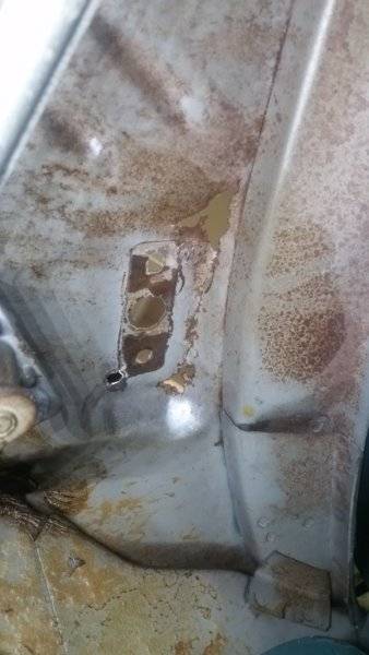

this last picture is of the passenger side which even had a few rust holes
