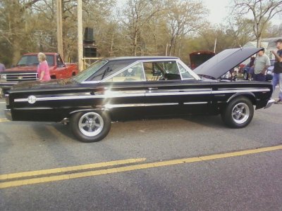

I dropped the front about 2" when I rebuilt the front end. I like the way it sits, but everyone has their own opinion.

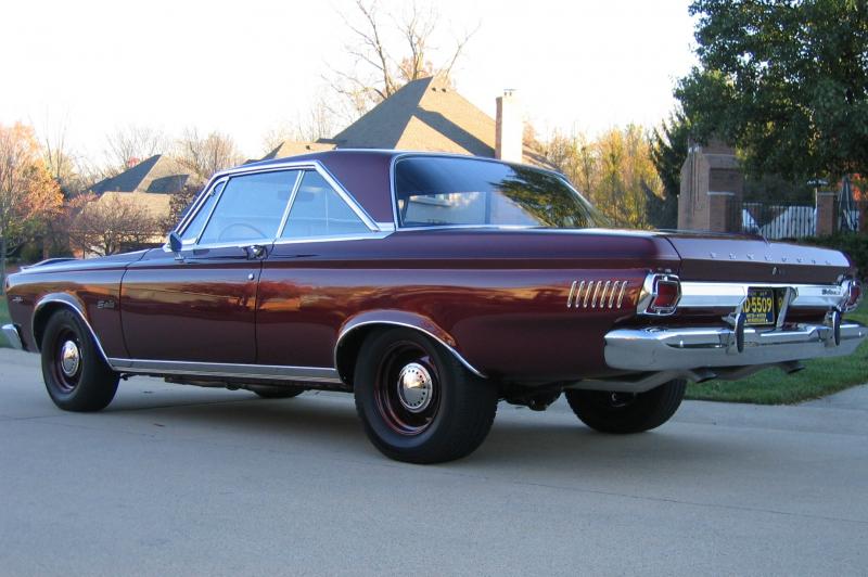

Measuring from the ground through the center of the hub cap, my front is at 27 inches running 225-75-15's and the rear is at 25 inches running 275-60-15's. Any higher in the front has a dramatic effect on the ride quality of this car.

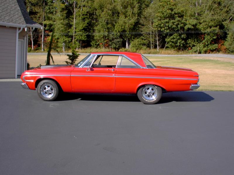

I run my 66 a little higher because of the 7 qt oil pan to. But I like the look of the front end up a few inches. If you run a little taller tire on the rear it comes out sitting almost level.
