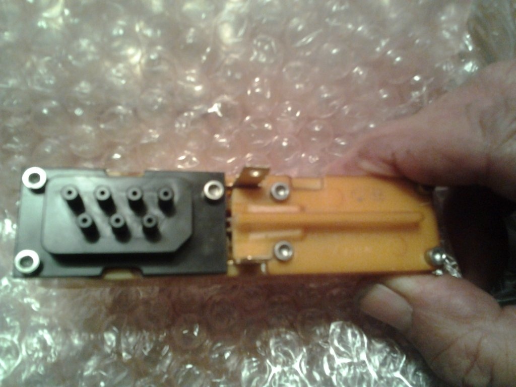

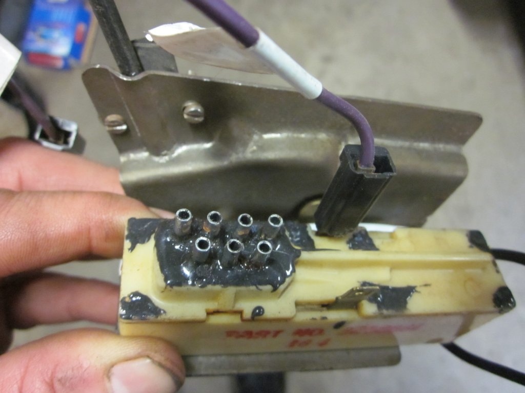

If you go to 1962to1965 mopar.org and go to the technical articles about half way down there is a 2 part article on fixing the heater control switch on a 64 plymouth. They talk about actually taking the switch apart and rebuilding it. I thought napa used to have a close switch that needed a port or 2 plugged. If that doesnt work for you is a dodge heater switch the same? I might have an extra one lying around.
I have a NOS one $95 + shipping.
I did this with JB weld & pop rivets. Worked out well.

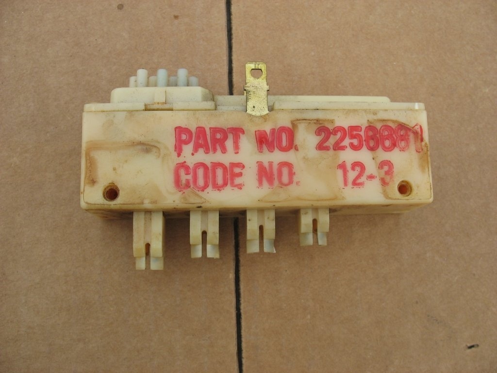

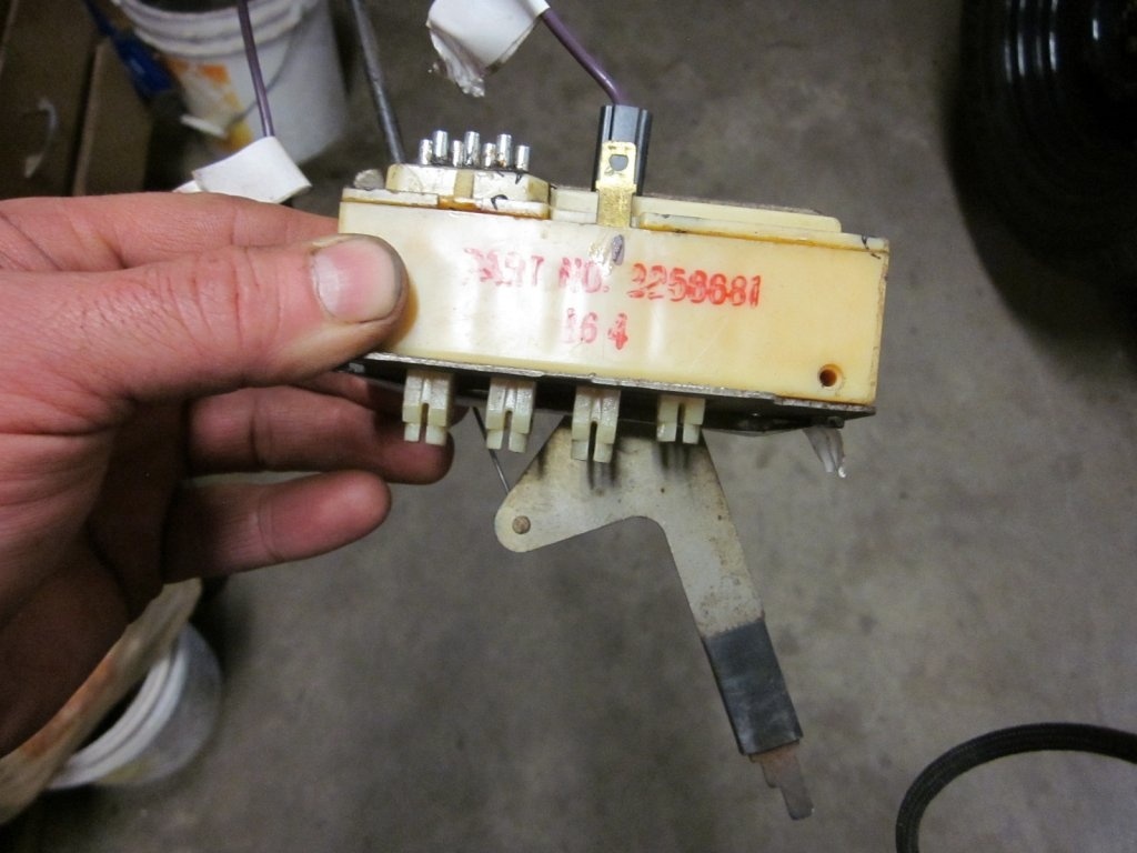

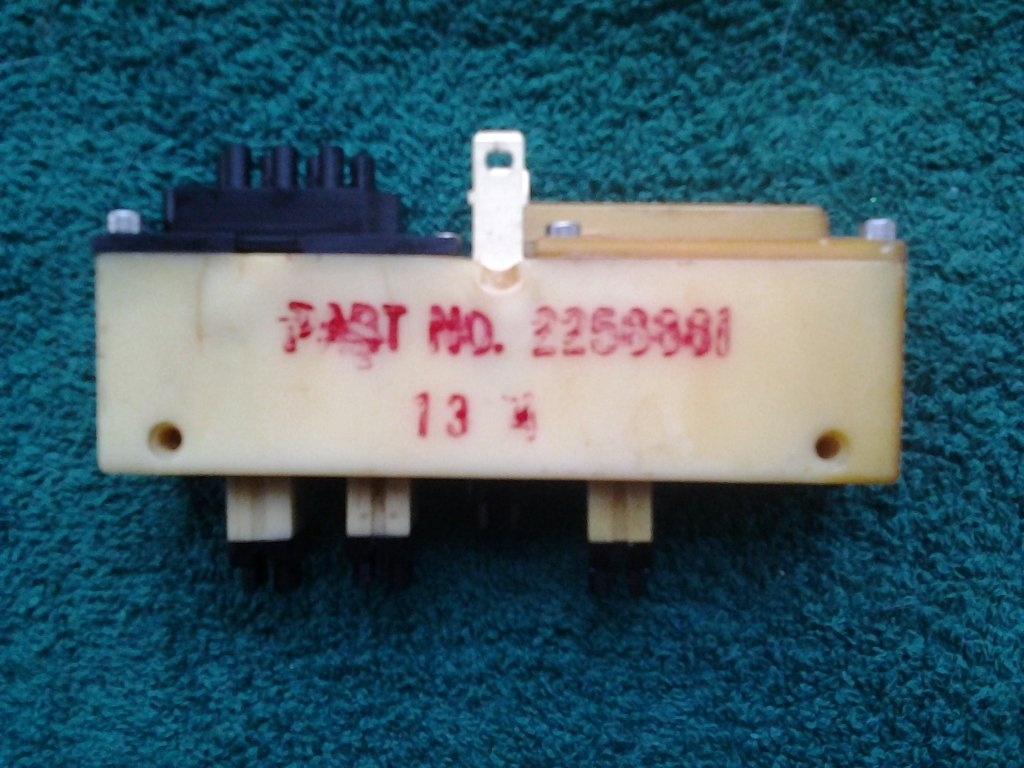

Here is the part number I am looking for
2496873 then below this number is 0182
several part #s for the same application
