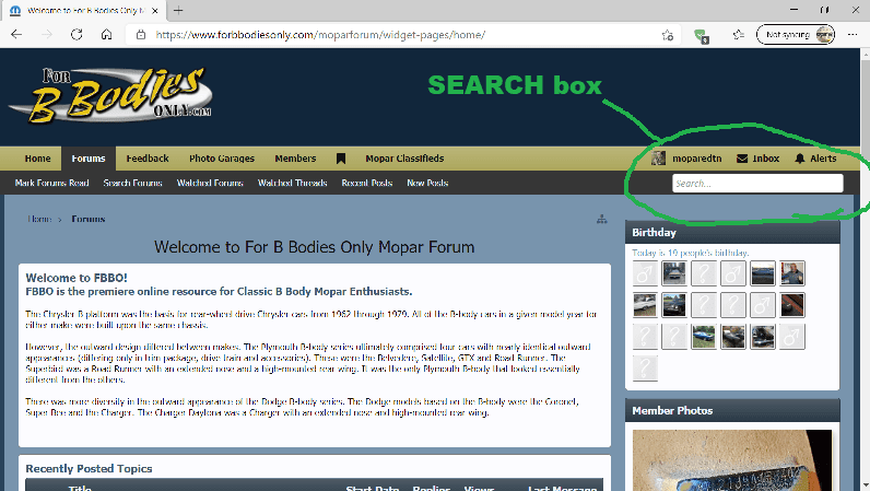

As far as the collective wisdom of FBBO members over the years goes, there has to have been literally
HUNDREDS of threads and posts on this subject already - which are to be found by simply using the
SEARCH box in the upper right corner of every page here:
Commence doing your due diligence!
