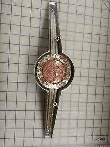

I need to get the wheel off to replace the turn signal switch. Dang, what's the trick. I have twisted and pulled and I don't want to break it. The bar across the middle is separate from the horn ring of course.
2 screws on the back? Let me check. (I just found a thread)
Yep 2 Phillips on the back of mine, but I have the fancier wheel
