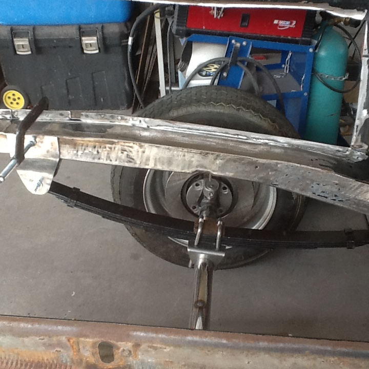

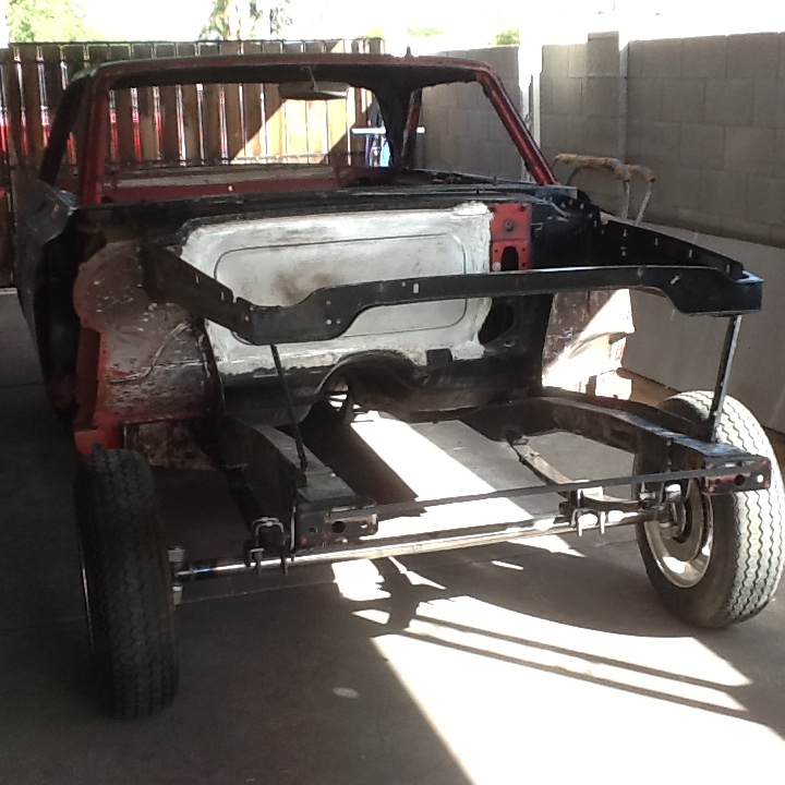

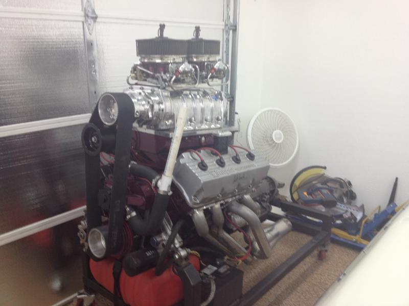

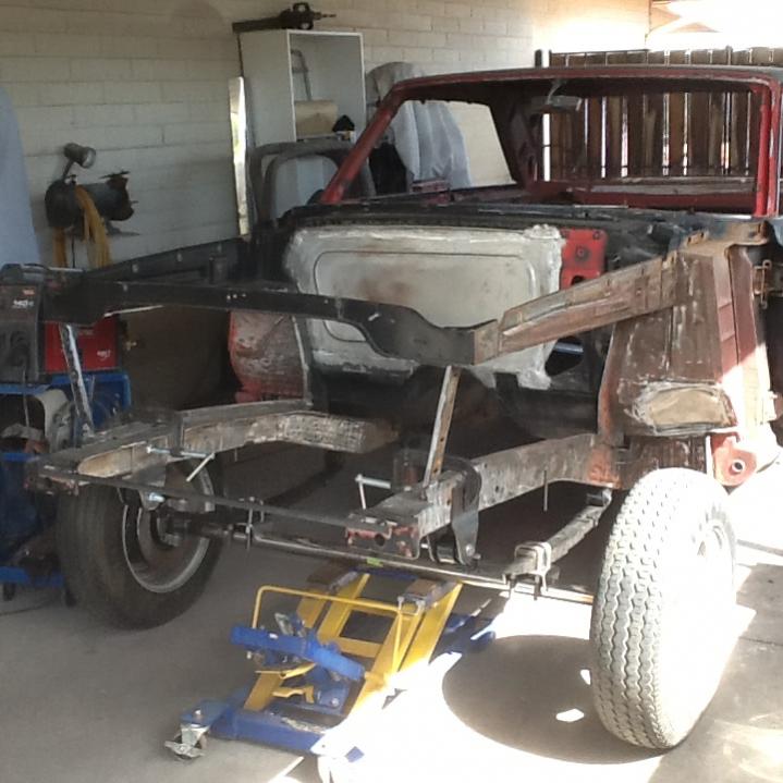

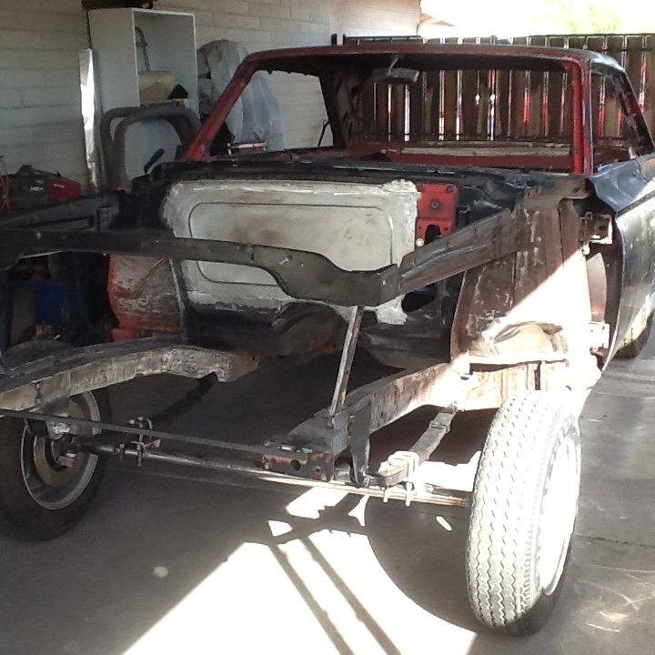

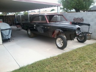

Hi everybody here are a few pictures from today showing the progress of my Project. Got all the old sheet metal removed and everything ground and cleaned off, hand built the new firewall and welded it in. Got the new straight axle mocked up and tack welded in and will finish the shackles this weekend and then start on the side panels installation and the mock up of the steering box and drag link.

Make sure the castor is the correct degrees before welding or the bump steer will be bad.
