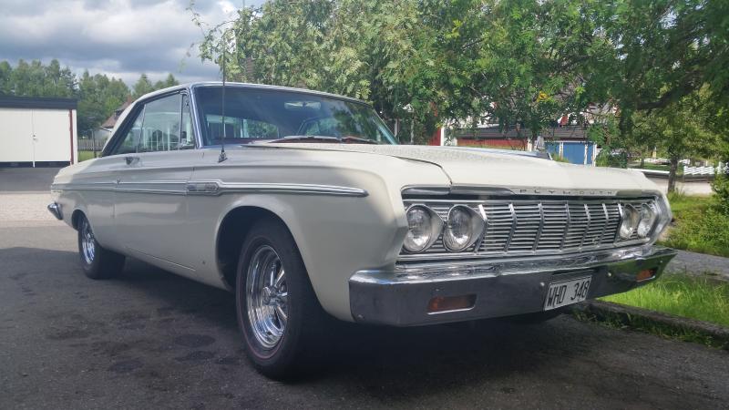

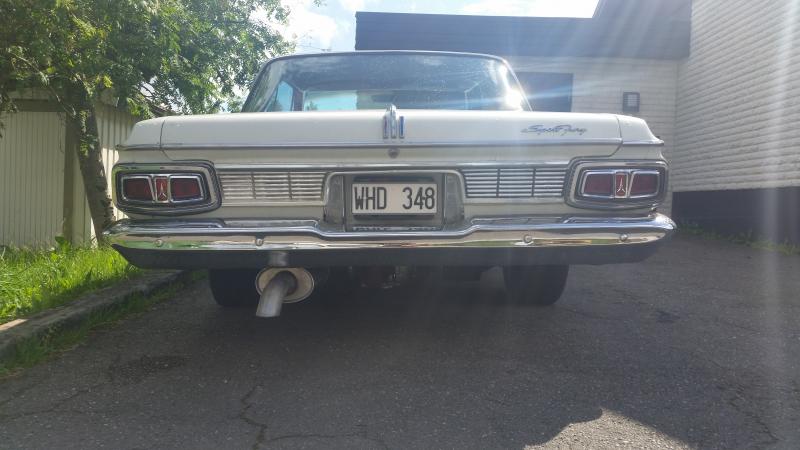

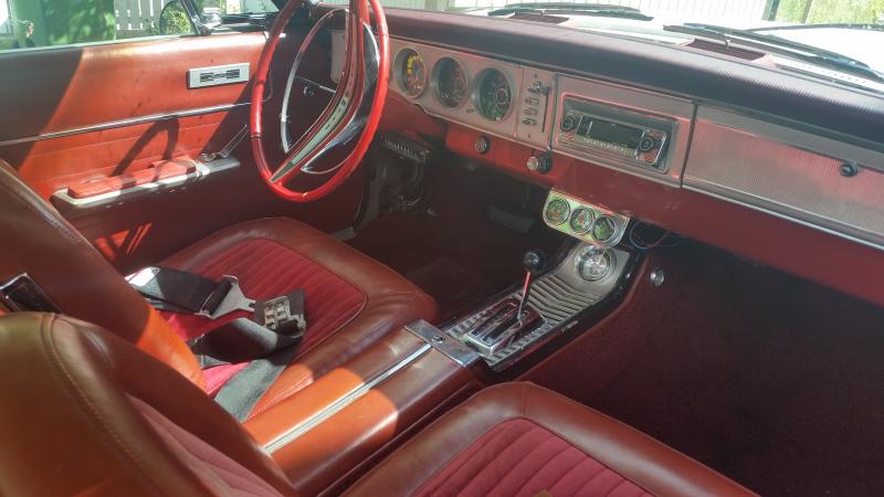

I think it's time to make a small project thread on my car.
It's a 1964 Plymouth Sport Fury.
Equippment

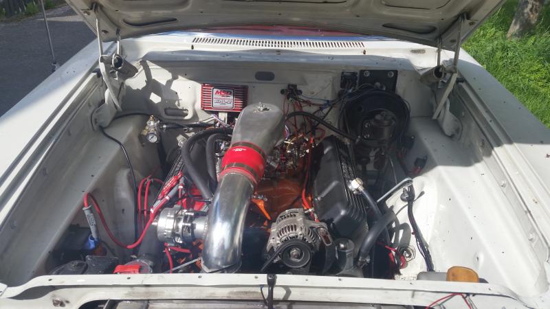

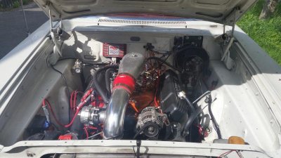

Engine:
0.06 over 400Bigblock (411cui)
Forged pistons, rods and crank.
Mopar performance purple shaft Hydraulic cam (very mild)
Quickfuel 650cfm blow thru carb
Edelbrock biplane intake
Stock heads
Headders
Msd ProBillet distributor and 6AL2 programable box

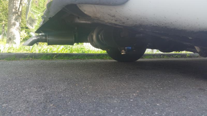

Remote mounted Garrett GT37 Turbo
Trans
Original '64 TF727 with TF2 Shiftkit
Rearend
Superstock leafsprings
Stock 8 3/4 3.23:1 and a Kemppi spool

how is the turbo lag with the remote mount?
are you running an intercooler?
cool car!
A very little turbo lag, direkt boost when i hit full throttle and i downshift. No intercooler i only run 8psi right now but i should run around 14 but don't have bite in the tires for that.

Made some changes to some piping under the car and made a couple of test runs.. knocks as hell on boost after sparkplug change so i'll swap back to old ones, cleaned and regapped them. Make some test runs later on today..
