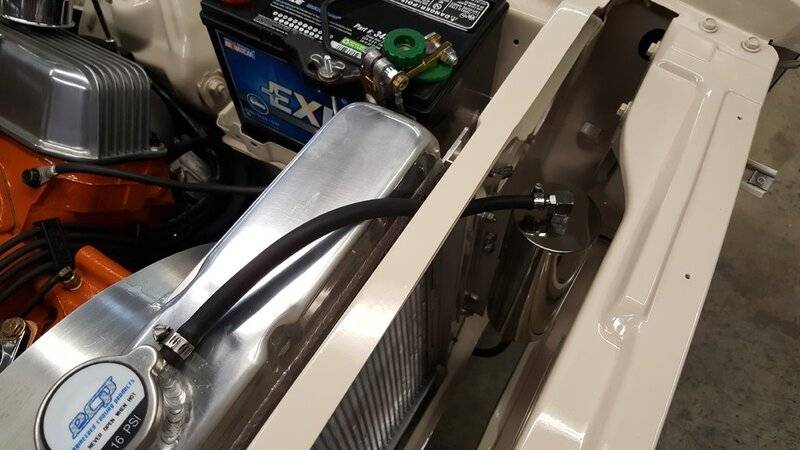

I bought this one from Summit. Just a catch can with a pitcock on the bottom. I leave my coolant an inch from the top of the radiator when the t-stat is open. I've never found any coolant in the catch can yet.

With the correct rad cap you can convert it into a recovery system, they work great. You fill the rad to the very top and whatever expands out goes into the reservoir(can) and when the engine cools down the water returns to the radiator. Lets you run a little more coolant without spilling onto floor
