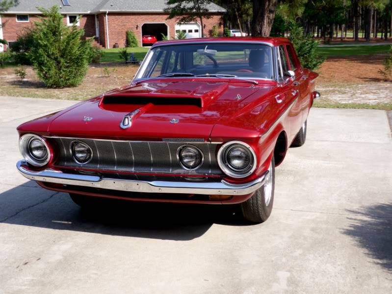

Kinda leaning towards this style.What would this type be called and the best place to get it?
if you go with the hemi scoop make sure to get a 64 65 one 66 and 67 look very similiar but 64 65 scoop the rear edge towards the windshield on 64 65 have a curve like the rear edge of the hood 66 67 are straight on the rear edge aar fiberglass has them kinda pricey around 350.00 i believe last time i looked but i think thats about the going rate for a good quality scoop.

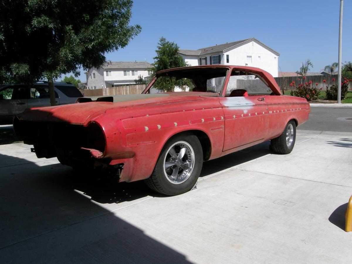

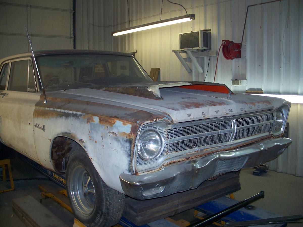

Jim Kramers is by far the best.One more scoop option that was available in 65 anyway,the taller A/FX scoop that was molded to the fiberglass hoods.This is a mold I have taken from an original Plaza Fiberglass hood.

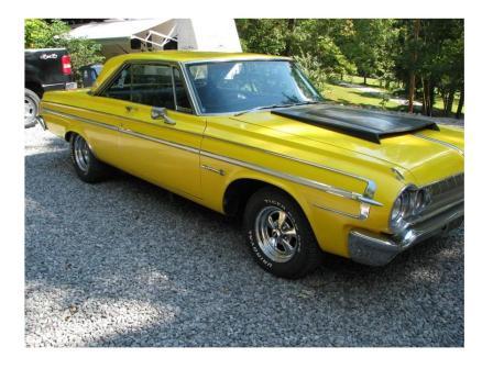

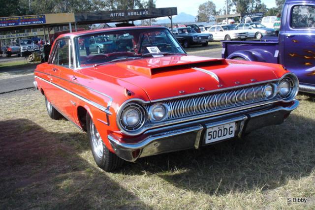

My 1964 Dodge Polara 500
Don't know where this one came from but the measurements are 33.5" wide in the front and 31" wide in the rear. Length on the sides is about 36" (35" in the center).
gotta find a 5" hemi scoop ..... i know sled city has them but not sure on the quality ...

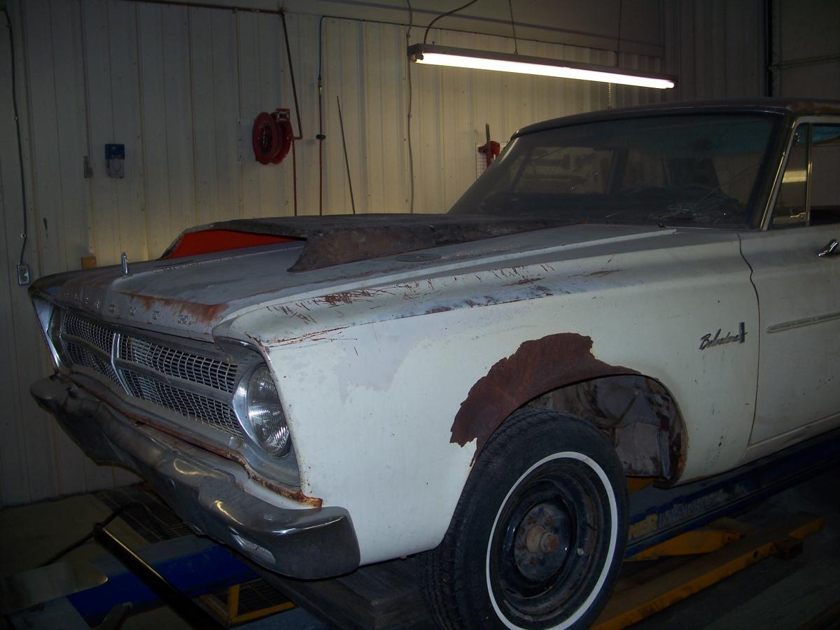

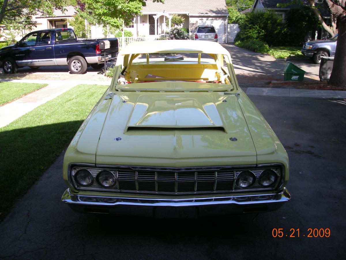

My hood
I thought about this one for about 2 seconds. I went with the full lift off glass hood !!

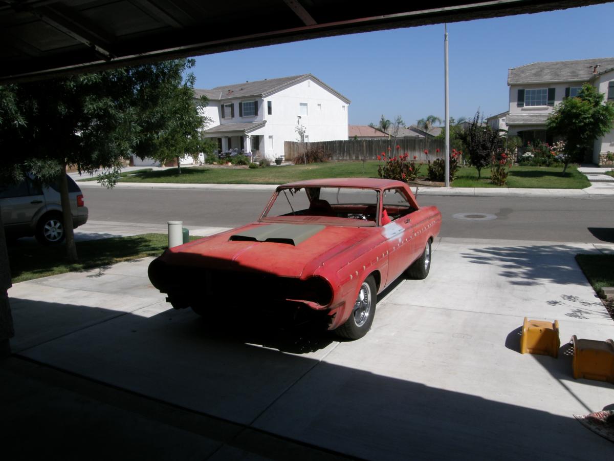

I looked into those a few years ago, at the time the price was $900US and a 12month wait.
I ended up borrowing a glass scoop to get the measurements and made my own(glass)........in terms of cash outlay, it owed me $70 by the time built it and got body color on it.

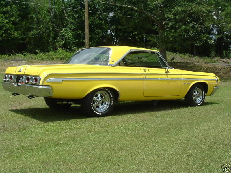

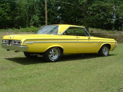

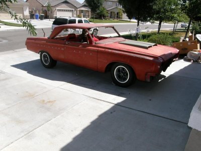

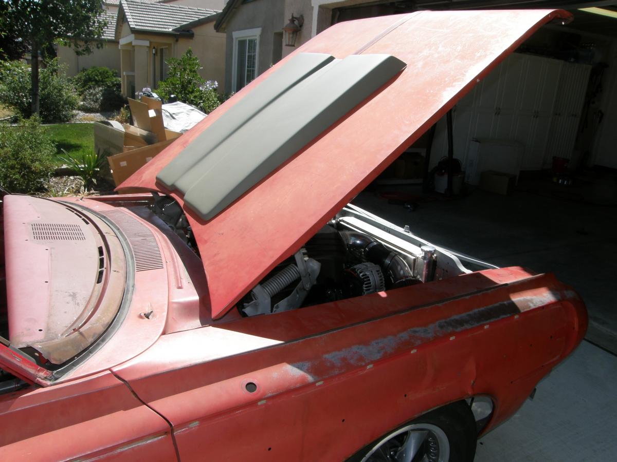

How about the max wedge?

Since you have a Max Wedge motor, I would go for the Max Wedge scoop...suits the car very well in my opinion.
