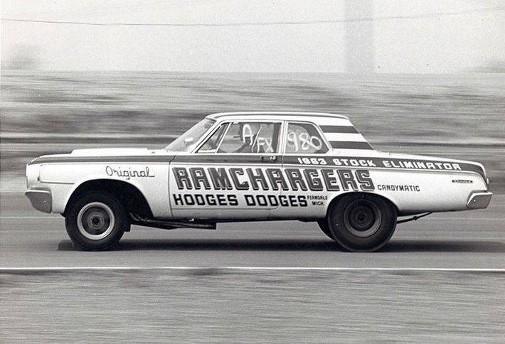

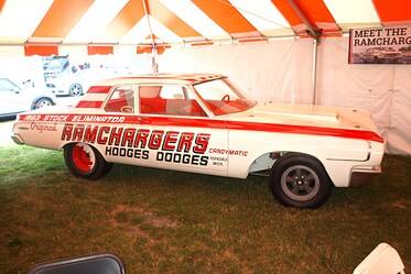

Original "2% car", 1964. Rear wheels look to be in stock location?
The rears appear to be moved ahead in this photo of the RAMCHERGERS car. Rear wheel house lip looks to be cut to fit larger tires?

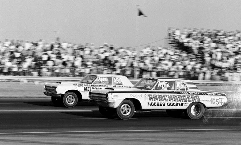

The "MELROSE MISSLE" does have the front wheels moved.

Ok the 2% cars had both the front and back wheels moved forward 2 inches , there were 2 Plymouth and 2 Dodges ,this was done so that they could get more traction with the new Hemi for 1964 .

I did a little looking and came up with the following: From Al Kirschenbaum, RAMCHARGER team member, Re. 2% cars- "...original cars were fitted with Max Wedges (for the Winternationals), but later changed out for Hemis- (Dodge) wheels were moved forward a total of 4 inches front and rear- front torsion bars were 4 inches longer than stock with the rear end including springs and shocks also moved 4 inches - to retain a stock look the rear wheel wells were actually moved 5 inches forward and carefully body worked- 4 factory cars in total were made- Ramchargers, Al Eckstrand, Dave Strickler and Tom Grove- All the 2% cars were built at a local Detroit body shop (Alexander brothers)- Landy did his own work, non factory car- cars came with a factory directive that they were to be used for FX and match racing only- with the Max Wedges these cars were unbeatable..." Jim Schild in his book MAXIMUM PERFORMANCE: Mopar super stock drag racing 1962-1969 states that the 2 Plymouth cars did not have their rear wheels moved at all "...the rear axles were left stock in the Plymouths because the cars already had a shorter wheel base than the Dodges..." Also, "...the first REAL Hemi (2%) drag car to race was the Ramchargers Dodge at Detroit Dragway in April of 1964- It ran in the FX class with Jim Thorton at the wheel and set elapsed time and speed records in it's class..."

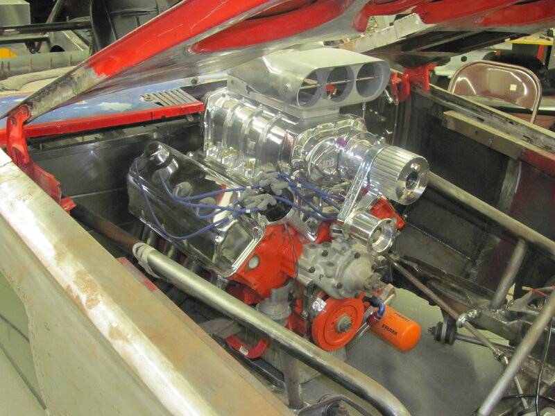

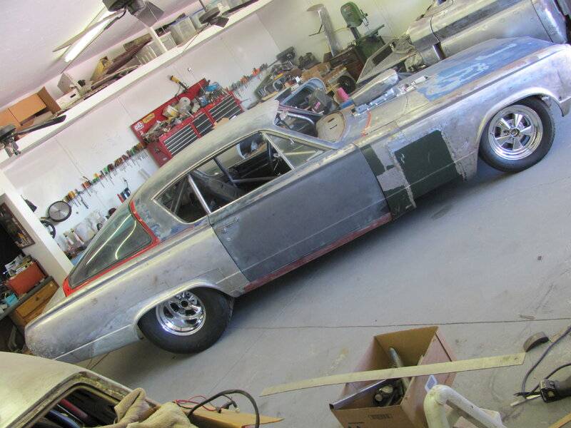

Thanks for all the replies. I may have been thinking about the 2% cars. Attached are some A-body's that look to have been made this way.
I recently picked up a 65 Coronet shell that would be a good AWB candidate. Its solid so leaving the back alone would make it all that easier.

I'm getting a real "Color Me Gone, Mr. Norm" vibe here Big Bill. TOO COOL!!
Very Cool!! I saw these photos in the back of a Mopar mag some years ago. Is this your car funnykarman? Great work, do you have any updated photos or a build thread? I REALLY want to see more!!!
I sold the 66 cuda to a friend but I have a 65 AFX coronet I am still working on . The 66 car is on the A Bodies Only web site under Old Mans 66 Cuda Funnycar build page 7 . The 65 car is in For Bodies only under 1965 AFX Coronet . It gets harder everyday to work on them I am 73 years old .
