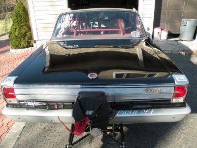

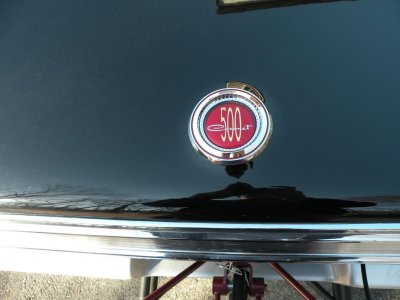

here;s my 500 repro medallion. you have to be real careful when tightening it down.orelse it pops out of the 2 retaining tabs.

The plate was swedged after the madallion was inserted! you might get lucky and do it again,be carefull it's pot metal also maybe use a little epoxy.
thats correct i had to use epoxy on mine i've seen the the inserts on ebay for sale for about 135.00 bucks.
I HAD TO SILICONE MINE AFTER THE CHEAP REPRO ONE POPPED OUT OF THE SWEDGE.
the silicone worked good also and acts like a gasket to support it on the trunk when you tighten it down.
