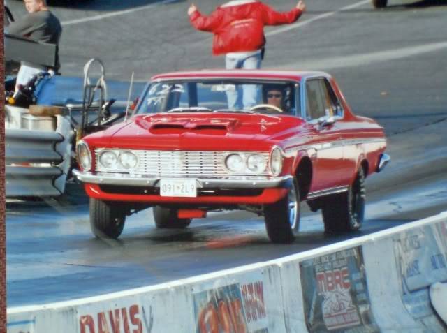

You can see mine here on my 63 Sport Fury. It has plenty of room between the road and has never hit anything. Its a Moroso 7 qt pan. Ron

I did not modify anything using the Moroso pan. I use the stock K-frame and it bolted right in with no mods. Ron

No actually mine is a Moroso pan and thats a Milodon. But that one should work also. I have not used the Milodon so I cant say for sure as I just know the Moroso went in with no modifing anything. And I like it when things are easy. Ron
Geez...it even says Moroso in your post...I just can't read....
