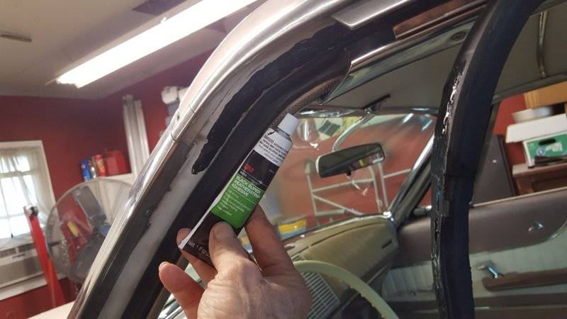

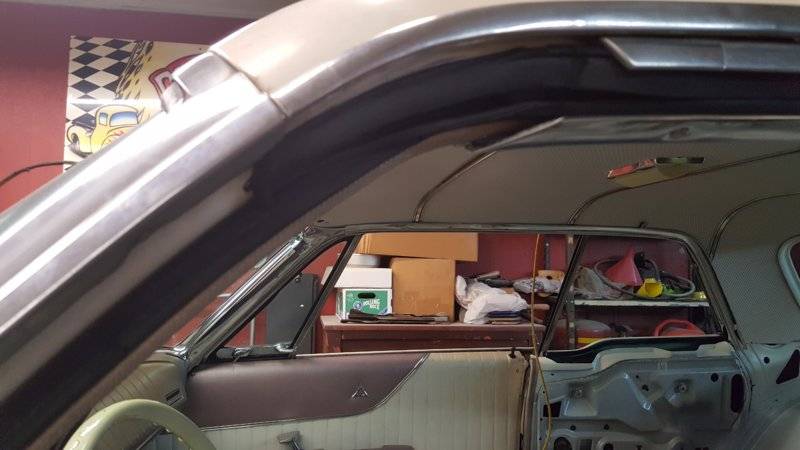

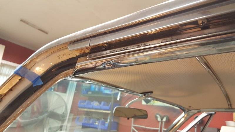

The trim piece that holds the seal has to be perfectly clean from any pieces left from the old one. A plastic scraper and lacquer thinner worked good. This piece is stainless so there was no rust!

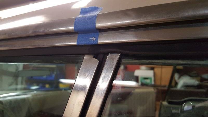

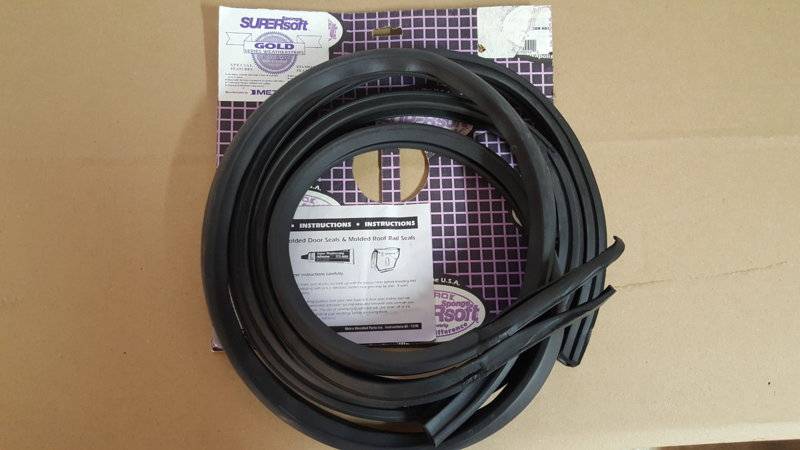

You can see that I marked, with tape, where the two glasses are located. The seal that I bought has two different profile pieces joined together right where the two glass comes together. That's where you need to start with the installation. The quarter glass fits inside the seal and the front goes on the outside of the seal.
The front end of the seal has a piece of flat metal inside. You just have to shape it to fit the curve where it is going to be glued. Clean any old glue off the paint with lacquer thinner and clean the new rubber with the same to remove any "mold release" that is on it. I used the 3M Super black adhesive. Coat both sides, wait till tacky and place together.

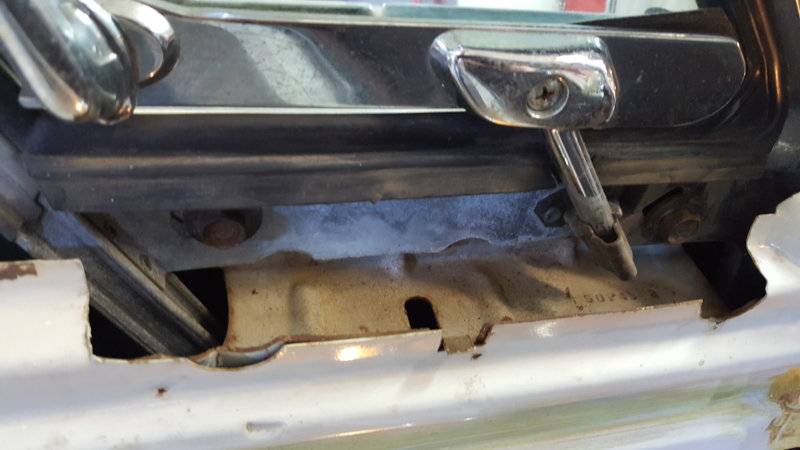

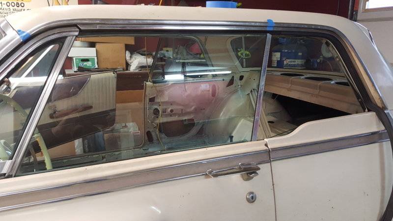

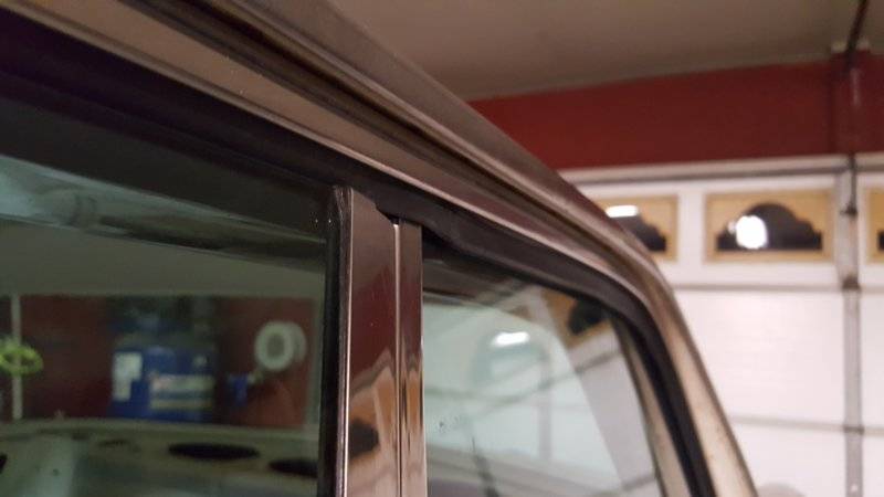

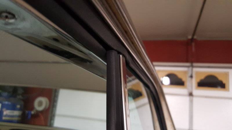

On the other end just leave about three or four inches of seal below the bottom of the window. Once installed, roll the quarter windows up, watching for any folding of the rubber. I used a thin plastic trim tool to help the glass into the groove where it belongs. Check it inside and out. Once in place I loosened the two lower track adjustments to let the window find center.

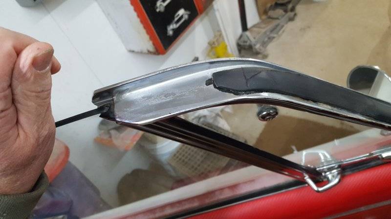

I didn't take that piece out because it was in good shape. I'm not even sure if the '62 is the same. This is the only pic I have.

Picture of my 64 HT seal. Installed it same place old one came off. Hope that helps.
