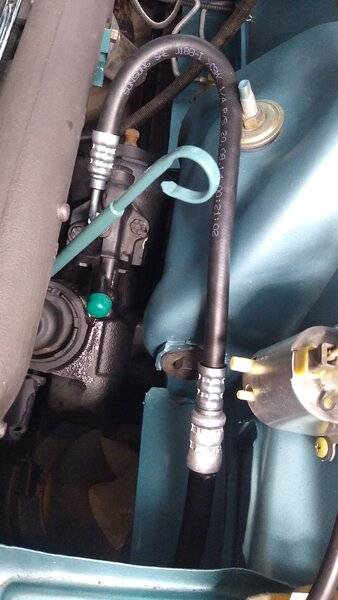

With the motor in I trying to figure power steering hose. I have 2 pressure replacement hoses. Sure doesn't look right.
Are you required to bend the ends or these are not correct? If to be bent is there a pattern out there?
Thanks
Oh, that doesn't look right at all....of all the lines I have seen, none have straight ends.
I think the proper routing is out of the pump and go towards the radiator, under the battery tray then back to the gear box. Requires curved ends though.
The correct pressure hose has curved steel line at each end. Go to RockAuto and find correct hose for your application. They are not that much $$$.

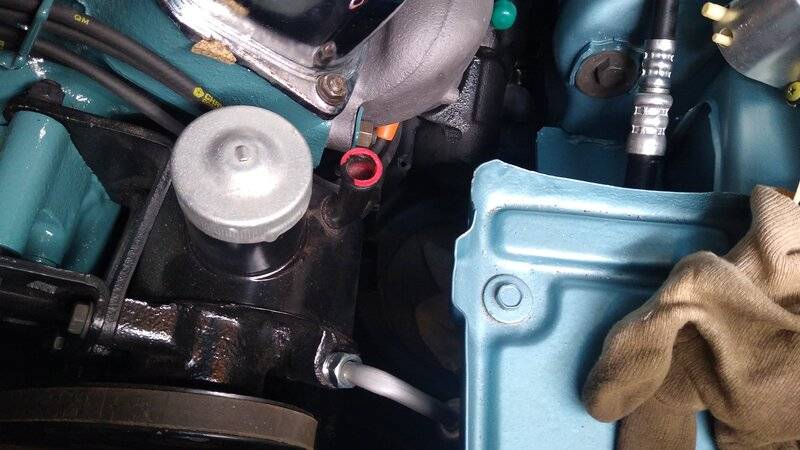

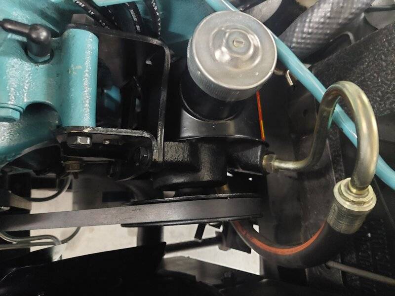

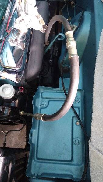

Got in the correct power steering hose.
Does this the correct routing?
Thankd
Much el better-o.

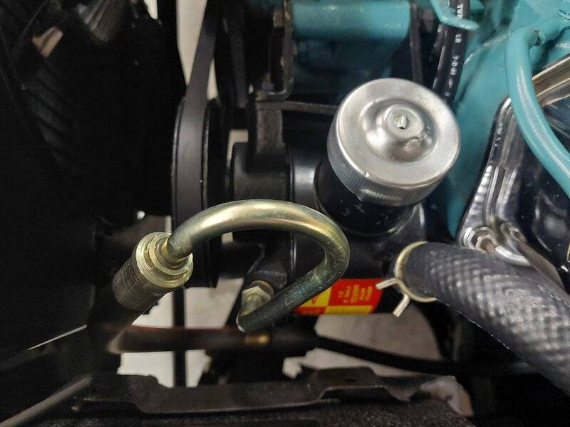

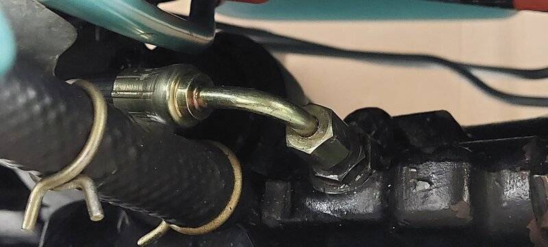

Can you link that hose to me when you get time....imma need one soon and that ine looks nice!
I was lucky to find an NOS hose for my 64 Sport Fury 426. Fits like a glove. Should be same for your Coronet
