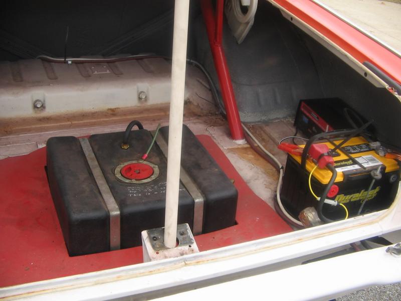

013.jpgOn my '65 Coronet, I split the wheel well and welded a 3" section between the halves, but I did not have rust issues. On my '65 Dart, I had major rust issues. I purchased reproduction rear fenderwells for a Chevy/GMC pickup from LMC and sectioned them to the right length and width. This is a strip only car and if you decide to go this route, you will not have a back seat. Much easier than the aftermarket full tubs however. Not a real good pic, but you should get the idea.
