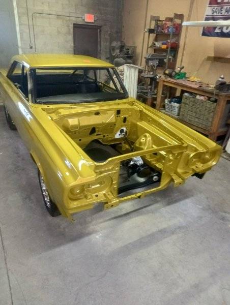

Just got done with paint... now to piece it together. If anybody knows where I can get raised front spindles
Standard height or 2" lower, yes. Raised, have never seen any myself. You could use a little bit larger diameter torsion bar, run the adjuster up a little extra once you get all the weight back in the car.
When I get the motor in, I will see what I can get with the torsion bars. A shop in California made custom spindles for gassers he closed up
Excellent start to a project. I’ve personally never heard of raised spindles, not saying that they don’t exist. Good luck to another Hoosier. I’ve got my 64 Savoy stripped and starting on some body work.
Excellent looking car/color ..... I think these guys are doing what khryslerkid posted.
