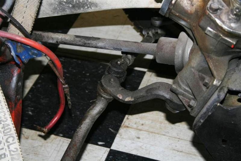

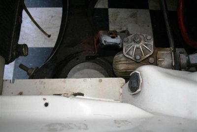

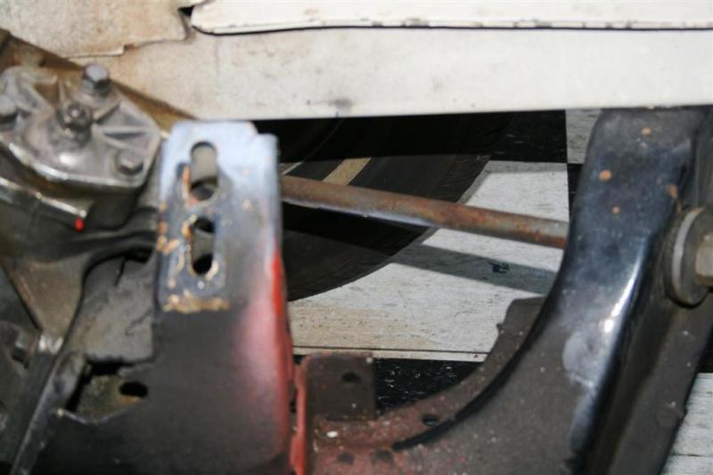

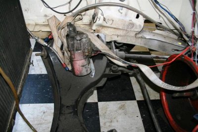

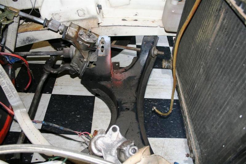

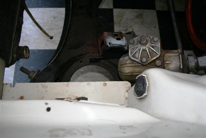

in 66 there was a k-member change,engine is in a different location then in 62-65.i changed the k-member in my 65 to a 70,now oil pans,headers and disk breaks are much cheaper and easy to get,mark
The car had a cheapo set of summit headers on it before.. i would have thought that the hookers would work..

if you want some pics,send me your email.motor mounts are easy to get also.my 65 has 2in. hooker super comps on it,mark

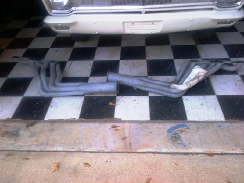

Header issue solved.. These came off of a 64 with a 440.... Yea...
