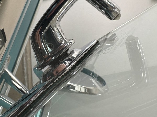

Ok, my vent window is handle is coming loose- For the life of me, I cannot see what is in there.
Just went through this , knock out the pin , handle will come off the shaft will have a slot on it take screwdriver tighten it up , washers or gasket might be wore out and causing handle to be loose if so replace , Joe Suchy or D.M.T might have gaskets /washer , can't remember which one , another thang this was on a 63 savoy.
