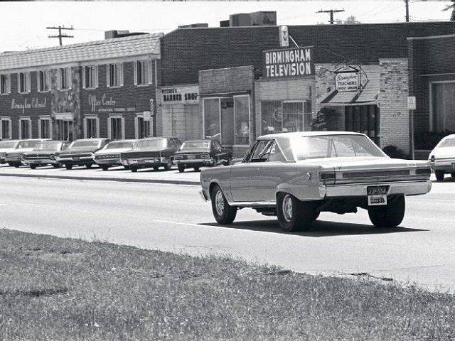

Silver Bullet! Subtle.
The Jimmy Addison 67 Silver Bullet GTX is the best example IMO. Legendary Motor Cars has a video on this car that may tell you what you want to know.
I have a signed poster of the Silver Bullet in my garage.. Friend of mine gave it to me.
I know I could probably never own the original, but an accurate clone would be nice. I don't think it's that hard to roll and stretch the rear wheel wells, but there will be various opinions on that.
I’m already aware of the Silver Bullet and have tried to find good close ups of the fenders. I believe they were able to fit a 315 tire on 8 inch wheel under the car. Tho it looks nice I’m looking to see other examples of things a bit more “imaginative”.

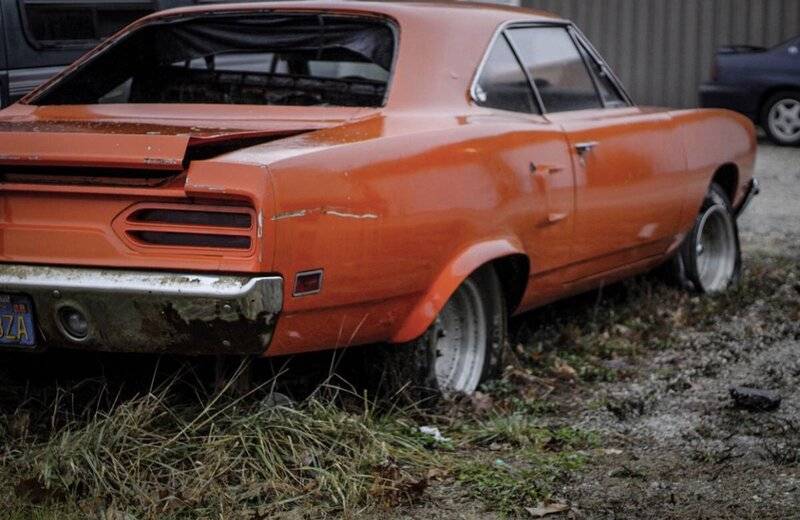

Some examples of what I was thinking of with other B Bodies
60E08AC6-269F-4191-9373-3926CBE79EBB.jpeg A5097AF0-1A0D-41BD-9650-675ED2CB80D3.jpeg
If you insist.... grafting in a replica of a 66/67 charger wheelwell might be a solution. (I am not advocating such). I've seen it done.

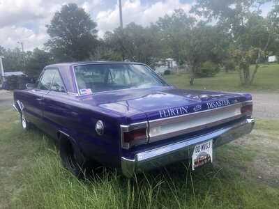

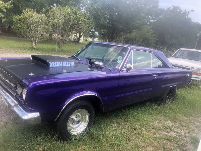

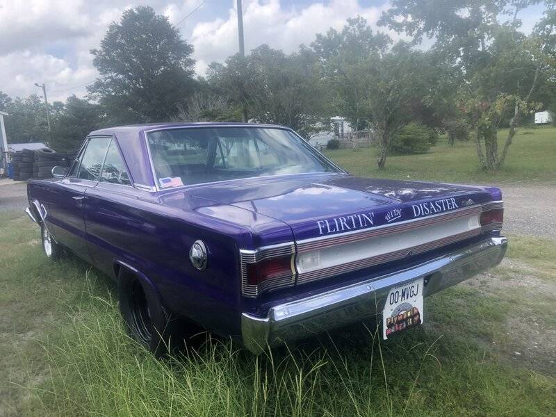

33D63911-BA22-46A7-BBEF-40D9B0855CD1.jpeg 8C110B49-B6B4-442D-A8CD-EC6470736562.jpeg
I like it !
Looks like you have a good start. I can see those wheel openings coming out a little but check for filler 1st.
Both sides have a little filler in the quarters but a good amount in the wheel arches. The drivers side worse then the passenger. Tried rolling and I started cracking the filler.
Kinda pushed me to the idea of just cutting out the metal and welding In new custom arches at some point

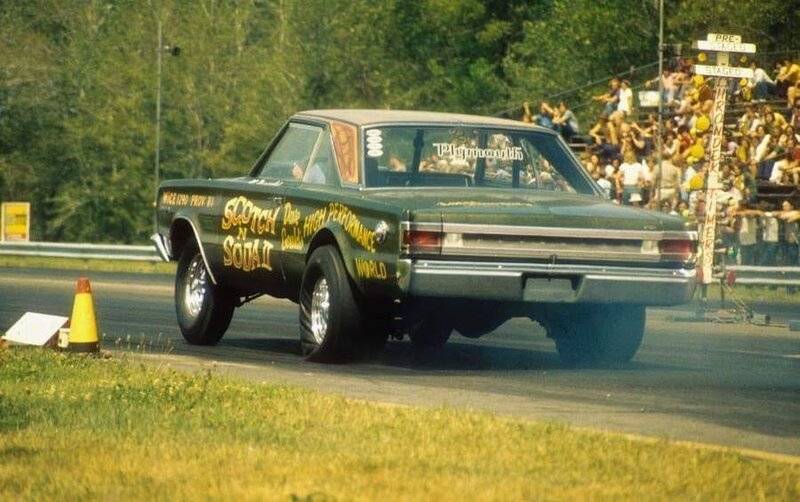

what ever way you go you will have to deal with the body line.
Those panels and the scotch & soda car look close.

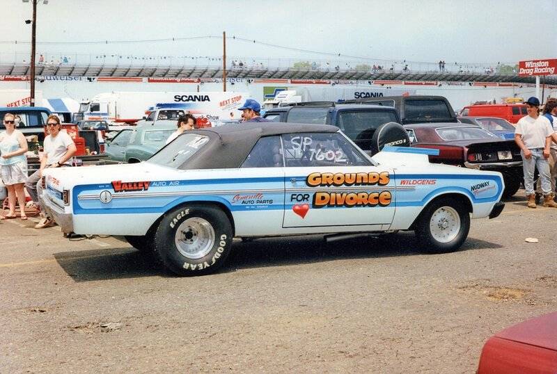

Exactly why I suggested the 66/67 charger wheelwells. They match the coronet body line since the lines are essentially the same, just more open for more tire room. Of the above examples, I think the best was the grounds for divorce car (except for the silver bullet, of course). The rest are just hideous beyond belief.
