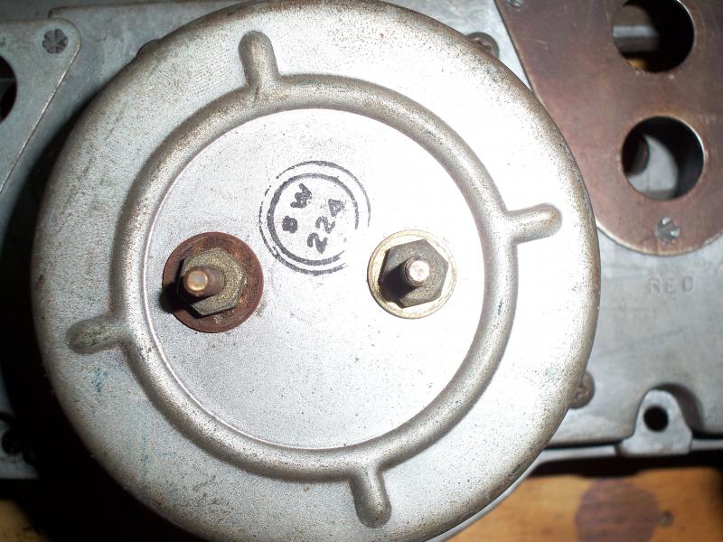

is that a 66 or 67...the tachs are different....

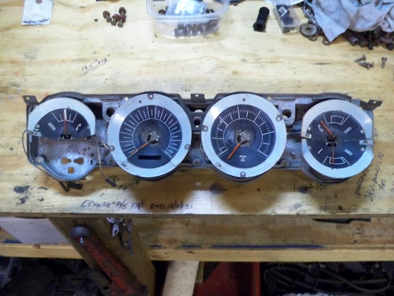

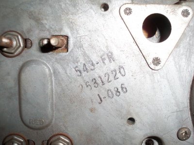

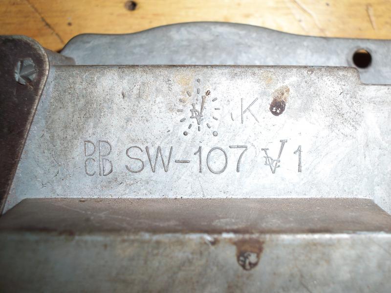

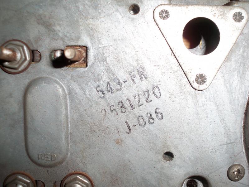

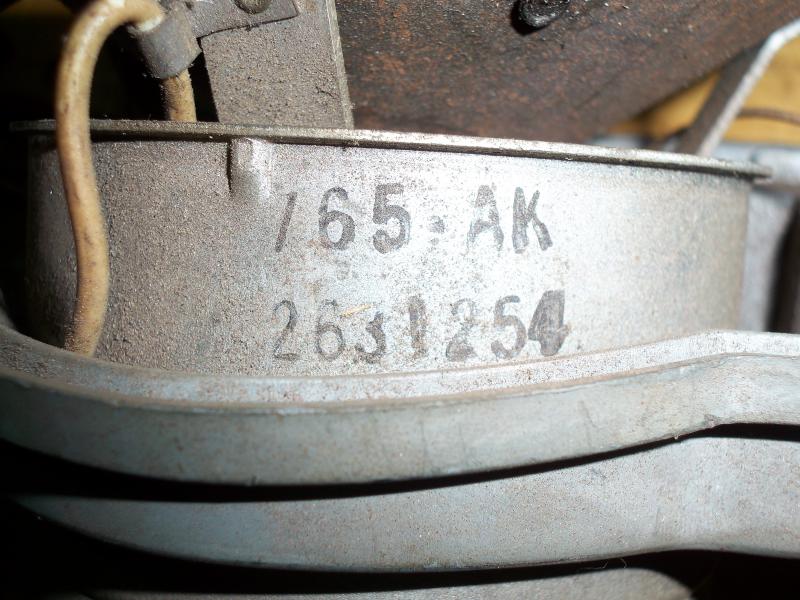

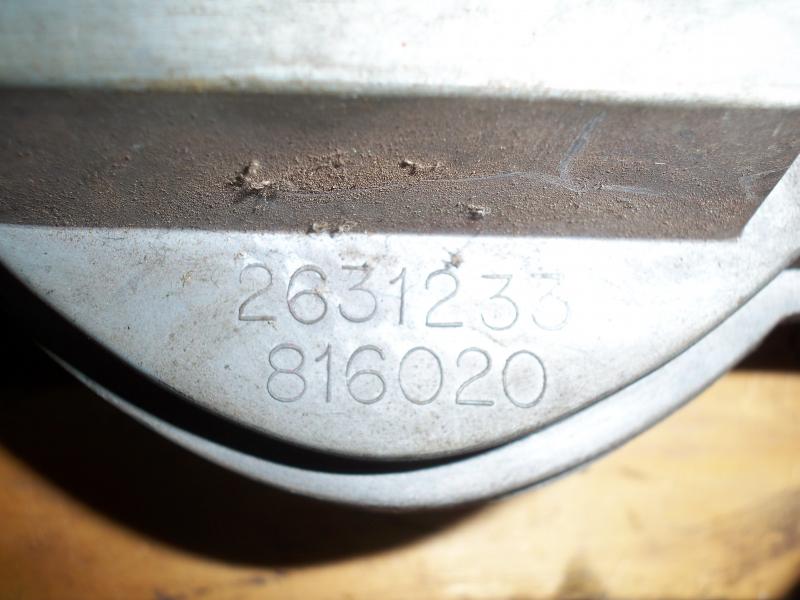

It came in a spare parts box with a 66 Charger I bought. Here are the numbers on back. Never had it hooked up and not sure how to test it.
Thanks, Ken
numbers mean nothing....need to see back of tach....if nothing works, not worth the money then
yup, gotta know if it works! thanks for the reply though
That is a '66 tach. Can be tested with a "D" cell battery. Hook up battery to the 2 post on back of tach, should read around 2-2200 RPM.
Bench tested Tach, Voltage gauge, Speedo. All work. Missing gas gauge. Not sure how to bench test lights, oil and temp.
There is a Tech Article or two over in 66-67charger.com forum that might help. (in Source Guide area, Interior, Gauges, Readings). Separate info at bottom for each gauge. If no luck, PM me and I'll e-mail you the links, etc. We have a 67 so I've been thru this numerous times.
