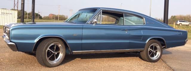

I also just bought one, I am slowly finding the parts I need, They are expensive, But I think the 66 charger is one of the best looking B-bodys out there. So many cool features in the interior, And great stance. Buy it you will like it!!
I just finished my 67 Aug 2017. You can’t be in it to flip- but they are so cool. Parts are tricky, complicated construction, and a zillion parts, but they are rare.
