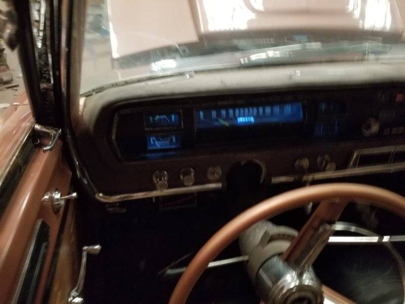

Dash lights could be the headlight switch. That is what powers the fuse for the insturment lights. I found that to be the problem on a 67 Coronet. Are you working on a Plymouth or Dodge? I have a few 67 Plymouth speedometers. They are easy to test when out of the car. I am also looking for a 67 Dodge speedometer in good condition.
Here is a picture working .
