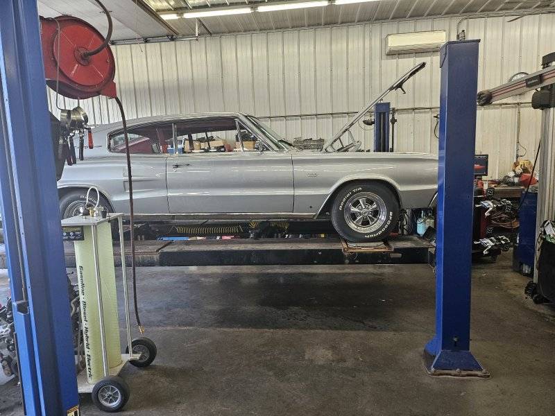

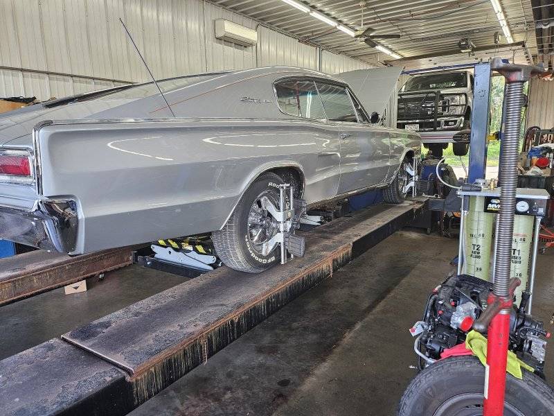

Final step and will be going home to its owner. Alignment my own specs. Advice do not use factory specs to align a B body.

After I rebuilt my front end, a few years ago, I contacted a fellow Mopar car guy that had many 60's era cars, he recommended an alignment shop in the next county that really knows what it takes to get the alignment right on our era cars. I had found and printed out this article (link attached) on alignment of our era cars. He used the "Skosh" numbers for my my alignment and it was, and still is perfect 3 years later. Don't use alignment numbers in the shop manual. I currently have Cooper Cobra radio GT's all around and am very pleased with that tire choice.

This is too true, the service manual was intended for cars that were made 50+ years ago with craptastic skinny bias-ply tires and all original parts, not modern upgrades and wider, lower-profile tires. Putting all that goodness on our cars and setting alignment specs to factory is counter-intuitive.
