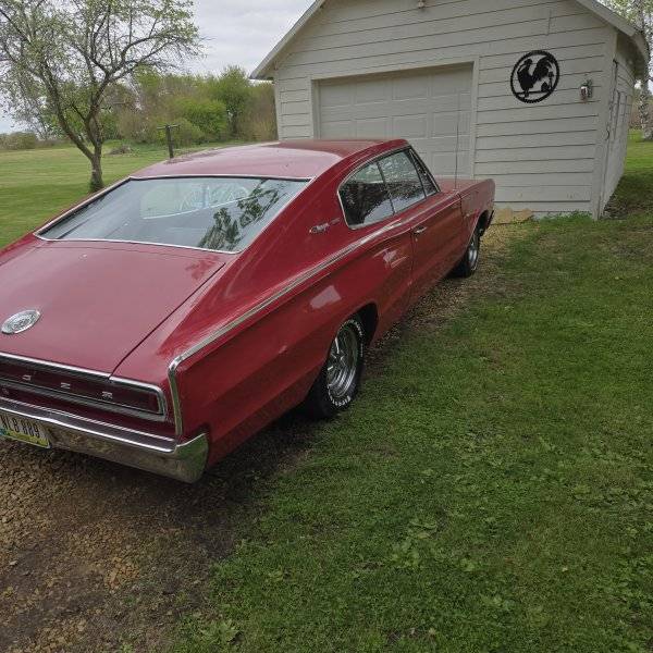

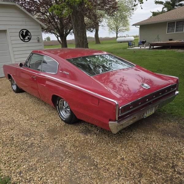

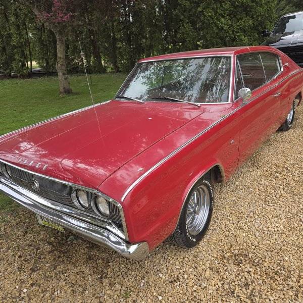

So as with any engine. There are good and bad when it comes to upgrades/mods.
I currently have the stock 318 but already has and eddy intake and 4 barrel. Now im NOT looking for balls out performance. Im asking what cam would work well to give me some thumpty thump. And gain some HP.
Also heads. Good lord so many options or opinions. Don't want to port these. But want to upgrade. Looked at many options. From crazy expensive. To remain bone stock. Looking for something in between. I plan on installing a set of headers and full exhaust. Im running a 3 on the tree. And pretty sure boring oem rear diff. Thanks again for any and all suggestions.

Nice car BTW. :thumbsup:

Since you've already got the intake and exhaust figured out, I'd recommend a good set of alum heads, perhaps the Eddy's, contact Hughes for a suitable cam, and 3.55's in back. 318's can be made to run quite well, done so many moons ago myself. That's a beautiful car you have.

Can you show a pic of the console and column? That's a rare one you got there
