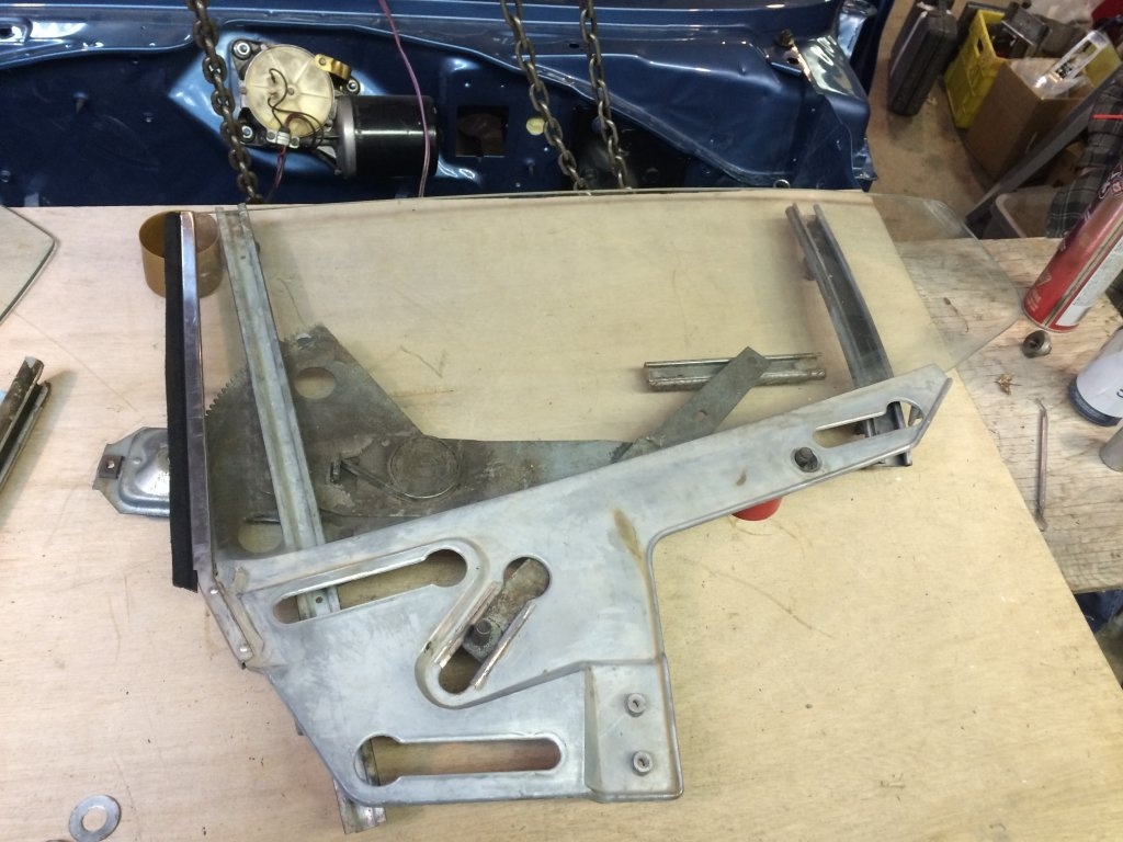

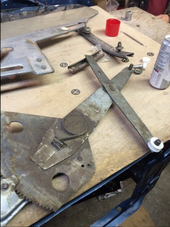

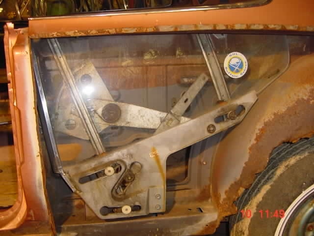

The rear windows are a bear to deal with. These pictures helped me.
