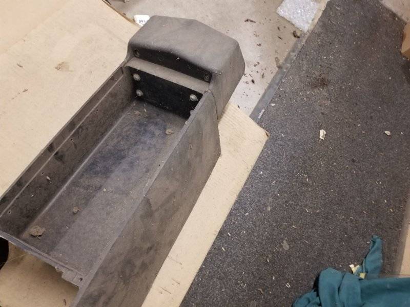

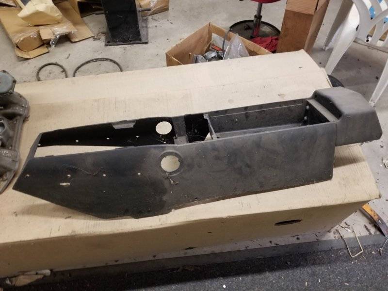

Looking for a good restorable 4 speed console for a 66 Coronet. Also can anyone tell me the difference why the catalogs list a console for 67 and up? Wouldn't a 66 be the same as a 67 console?
You can use a 67 up console in a 66, and installed they look the same. Most 66 consoles are 2 piece. 67 up are one piece.
Design is the same. The 66 console is much thicker and 2 piece.
So I'm looking at a lot of pictures, besides the console I would need the correct shift handle for console use that has the offset to come out at the center of the console. correct?
The top plates 66-68 are the same. The correct shifter for your application is the 66-68 Inland console shifter. There are other console shifters that will work for your application.
