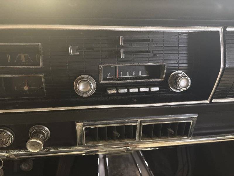

Interesting. Here's my issue: my dad swears this was equipped with AC originally. I have never know it to have AC. It currently has an instrument panel bezel that only has heater controls. He's slept a few times since his younger days, and cant remember the whole story about that bezel. He's thinking that he replaced it with one from another car. I have tried tracing the wiring harness. It's spaghetti, so I'm still working. What is the physical fitment issue between AC equipped, and non-AC for the 66?

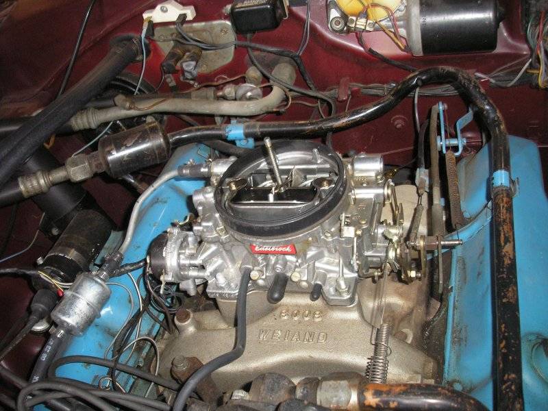

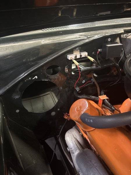

Show us a picture of the firewall from the engine compartment. That will tell us.

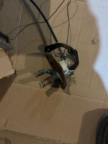

These are 67 Coronets. First one is AC second is no AC.

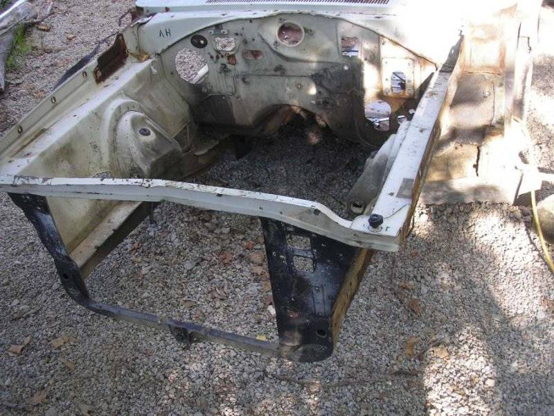

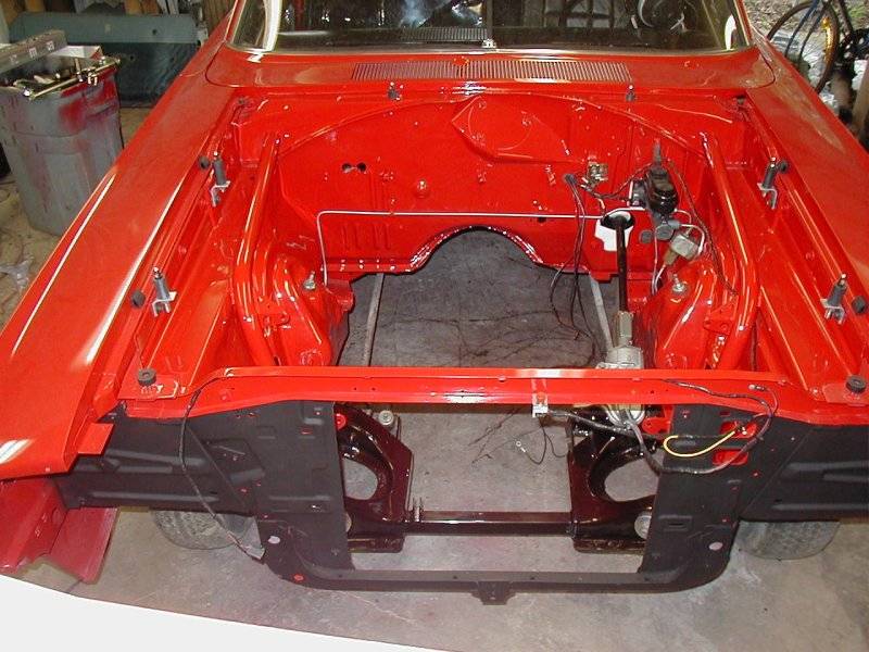

Picture of the firewall will tell the story. They are vastly different in number of holes and how the box itself mounts
Non AC boxes use 3 nuts to secure it. AC boxes use 5
Like said, they will not interchange without a whole lot of work on the firewall

Well, 65CopCar, I believe you have helped solve my puzzle. And verified Dad’s thought. This appears to be a match for the AC equipped Coronet. In all his years of swapping parts, it looks like he used a Heater-only Dash panel. Jeff is very local to me. I am going to check his part stock. If he doesn’t have one, I would like to see what you have!
