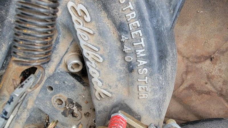

I'm not familiar with the "Streetmaster" intake but being a single plane, I'd expect it to not be a great intake for general purpose cruising like a dual plane would.

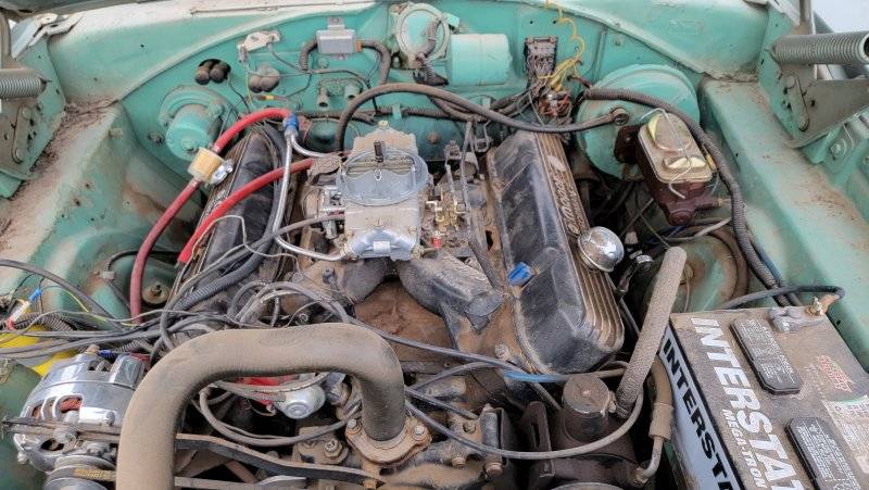

For dependability and reliability I'd ditch the ignition system you currently have and get yourself a stock OEM mopar electronic ignition system, then if you do have problems out on the road you have a very good chance of getting repair parts from most places.
New tank, replace all the rubber lines in the fuel system, ditch that red fuel line running up over the headers and valve cover, buy a reproduction metal fuel line from fuel pump to carb with a proper metal canister fuel filter. Once you get the fuel tank, lines and fuel pump sorted out I would probably want to loose the Holley and go with an Eddelbrock 650/700/750 Vacuum secondary carb with electric choke, good reliable carb right out of the box with decent driving characteristics and minimal tuning required to get decent performance and fuel consumption numbers. Loose the single plane intake adn get yourself either a stock cast iron dual plane or an aftermarket dual plane.

That intake has proven to be better than the ubiquitous "Torker", but that Torker has also been proven to be "not nearly as bad" as a LOT of people say for low end.
I wouldn't mess with changing it. Instead, if there are drive-ability issues, I'd consider a vacuum secondary carb.

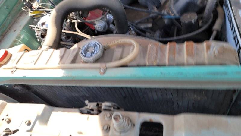

It looks like your car originally had factory A/C, by the arrangement on the firewall. This would also explain green tinted glass on your car.

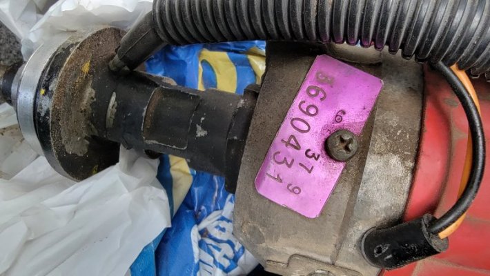

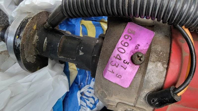

Too bad your extra mopar performance distributor is for a 383. Would have been the way to go.
The Pic of the loose Distributor was sitting in the backseat. I THINK it was what was on it before or the guy was using it to diagnose the Ignition issue it had... I don't know. I haven't messed with that one in the pic.
The engine wiring harness looks like it's seen better days.
You can find one from Classic Industries with the plugs/connectors for electronic ignition and a newer electronic voltage regulator.
*Warning: their website sucks so this is not the easiest thing to find.
But this would allow you to easily put in a Mopar style electronic ignition and a mopar style "square back" alternator.
That huge alternator in there worries me a bit as the old wiring is not designed for it.
