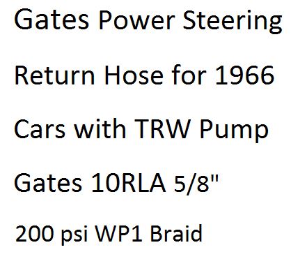

The current hose is a combination of differant types and sizes clamped together . It must be 5/8" at the steering box and 5/16" at the pump. I was hoping to find an replacement hose that included both sizes
Gates sells the proper hose. If your pump doesn't have a 5/8" return some adapting is needed. I have the proper TRW pump housing with 5/8" return.
